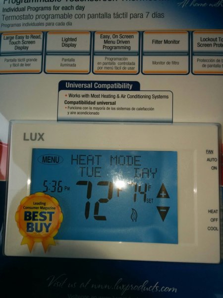

    Ok this is the thermostat I went with .If anyone know what wires to use that would be great. My standard CB 1200 thermostat only uses 2 wires. IMG_20150925_122132.jpg

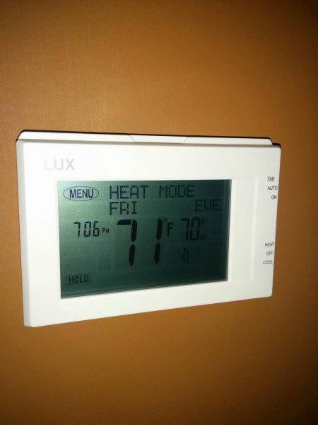

    On my lux I went with the white wire to W1 and red wire to RH, also the Rh is jumped to the RC
    Russell likes this.

    Ok looks easy enough . What's the reason for the jump wire ?

    Comes that way and no reason to remove it.

    RC designated power for cooling, RH for heating.

    If you're using the stat just for the pellet stove (heat), you can remove the jumper.

    Ok all set up let's see what happens. Left jumper on for the moment will that be ok? . IMG_20150925_190553.jpg

    Yes. I have the exact stat.....it will still work fine.

    The swing is 1 - 9 I set it at at 2

    Number 2 would only be 1/2 a degree swing, if you want a 2 degree swing you need to set it at 8, unless they really changed their thermostats.

    I'm reading up on that now , you're correct . Thank you I'm getting there .

    Each one is .25°. So 8 would be 4° total swing.
    2° isn't enough for that type of stove. Having owned one for several years, a hot start is not good on the glass, thermocouple, firebox, etc.
    I'd run 8-9 on the swing. A Quad can be a dangerous stove if the thermocouple doesn't cool enough and the stove restarts. The flame is HUGE and sounds like a freight train.
