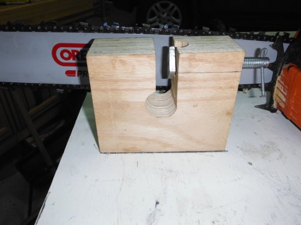

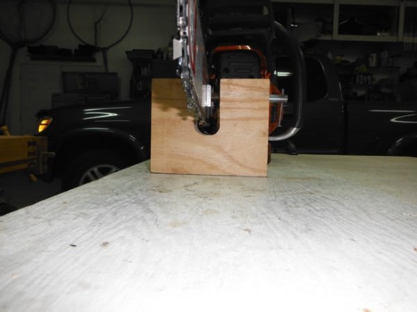

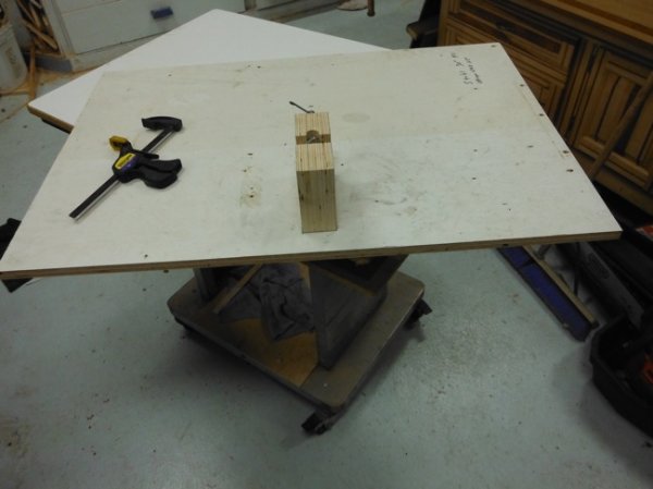

    I built this vise on a piece of 3/4 plywood so it's portable
    Clamp to a tail gate, atv rack .... etc
    Glued 2 pieces of 3/4 plywood together, drilled a hole & cut out a grove for the bar.
    piece of all thread, epoxied in a nut. drilled / tapped the end of the all thread, counter sink for a screw in a piece of aluminum for the vise jaw.
    Glue & screwed up from the bottom to mount it .
    Fits in the back seat of the P/U fine
    nice flat saw work table if need .
    Beats the heck out of working on the metal tailgate of the P/U.
    It sees a lot of use in the shop too, it gets oil & dirt all over it, carry it
    to the trash can or out side & clean it off.

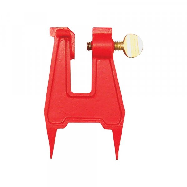

    One like this? I have one somewhere I have used maybe twice. It works fine, I just rarely get the perfect stump to work from, and haven't had many big rounds when I need one.
    You want it, I'll find it.

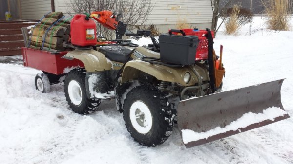

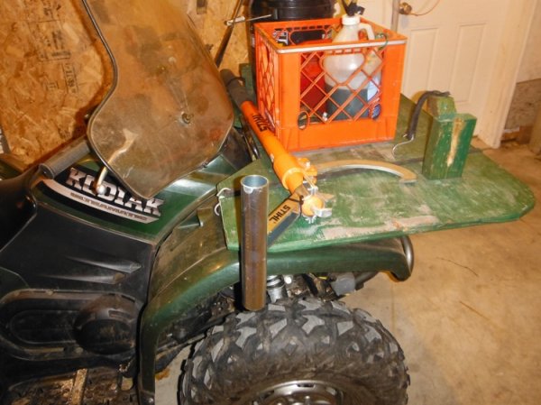

    I have a small tool box mounted on the front with extra chains and some random tools, rags, gloves, and glasses. My leather saw bag is in front of the milk crate. Has files, scrench, wedges, my measuring stick, and a tape. A milk crate for a small can of mix and a jug of bar oil (small can of mix isn't in there now), and the saw goes in the saw scabbard in the back. (Large gas can normally isn't on there)

    Plywood cover for the atv rack is a good work surface.
    I screwed some stuff to it, crate, saw clamp
    Customize for you needs

    You have tables to work on.
    I seen some of you pictures, close to one log loads from some of the stumps.
    Oregon stump vise , $20
    campinspecter likes this.
