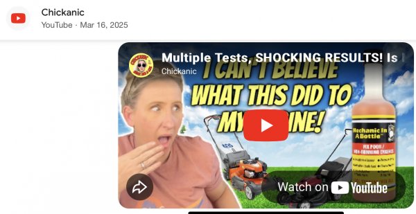

    Let me start by saying I’m not a big proponent of a lot of the snake oils on the market. I’m beyond skeptical of anything that claims to fix everything from $hits, fits to sore tits. But with that being said ( you knew there was a “but” coming), take a little time with your morning coffee to google this video and give it a look.
    This gal has some good product test and comparison videos.
