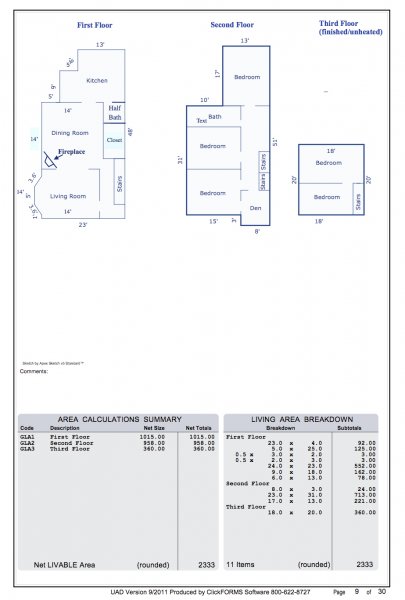

    My home is a bit over 2000 square feet, three story victorian from 1890s with original windows (a bunch of them and they are large at 34.5"x67") with not so great storm windows added in the 80s or 90s, I had blown in insulation in all the walls, and it's fairly drafty. We mainly used the first two floors, but the third floor is a nice finished non-heated attic - I'm not too concerned with heating the third floor, but I would use it more in the winter if it were warmer up there. I have a forced hot air furnace on floors one and two, and 9 foot ceilings throughout the first two stories. My first floor doesn't have an open floor plan, but there are open doorways throughout (with no doors on them), the stove is in the center of the first floor, there is an oversized open double door opening from the stove room to the living room next to it, and the stove room and adjacent living room both have open doorways that lead to an open staircase up to the second floor. The staircase to the third floor is also open (meaning no wall against the stairs so air can flow up/down the stairs). One other possibly relevant detail is whatever the temp of my stove room, the upstairs is generally about 6 degrees cooler - so if it's 71 in stove room, it's 65 upstairs. Not sure if this would carry over to other set ups.

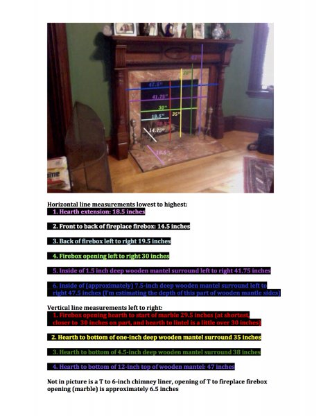

    I did a cardboard mock up of the Ideal Steel, and it does feel a bit large physically for the room, partly because I'd need to pull it in front of the mantel. My wife thinks that it's too big (both physically imposing and fears it's going to get us too hot), but I feel that a big cardboard box that was the mock up looks ugly whereas a big Ideal Steel would be beautiful! She's also always cold in our house currently, so I don't think she'll complain about the warmth, unless it is really so hot we can't sit in that room. The stove room is about about 15' x 14' with 9 foot ceilings, but does open to the living room with an open double door, and the kitchen with a single open door, and the hallway to the stairs with another open door.

    I know you don't want to wreck the mantle but I'd rip it all out and get the stove as close as possible to the wall. Maybe you can use the mantle for something else?

    Why do you say tear the mantel out? Do you think the horizontal run will hurt the draft/stove performance, or just for the sake of not having the stove so far into the room? Woodstock thought the 18 to 20 inch horizontal run would be no problem for draft/how the stove runs as I have such a tall chimney. I haven't totally ruled out tearing out the mantel, but it really is a last resort. I love adding modern features to my home, but also love keeping these amazing original touches. It also means a whole job of removing it, then patching... All of which I'd need to get done by May 31 delivery date of the stove (if I am to take advantage of Woodstock's current sale and free delivery).

    Myself personally, I would have to disagree with Babaganoosh ^^
    I love old architecture, especially the woodwork, so there is no way I would get rid of that mantle.
    We are really happy with our IS stove, but through your mock up it seems it would look a little out of place that far forward from the mantle/fireplace.
    The IS is a wonderful stove, but for what you have, and what you want.. I'm just not sure it's the right stove for your situation.
    However, if it could be installed separately, once again it would look out of place, but it might work aesthetically, I'm just not sure though.
    Ultimately the decision will be yours. The IS is a beautiful, and extremely functional stove, but it just might not fit with your existing decor.

    First, it was good you talked to Lorin (the manager). She is very knowledgeable when it comes to the stoves. And no, I do not feel having that horizontal run will harm the performance of the stove. We have around a 2' horizontal in single wall and it does no harm. However, code says you must have 1/4" rise per foot of horizontal. We went 1/2" rise per horizontal as I like that better. Nothing says you can't exceed code.
    As for the stove not matching the decor, I don't see any problem with it no matter the IS or Progress. Either of those stoves would work well, but I am a huge fan of soapstone. The main reason and a big reason for you is the type of home you have and the fact that it perhaps needs more insulation and stopping of any drafts. Soapstone will radiate the heat much better than any steel or cast stove. For example, in our home we used to have a problem getting heat to the rear of the house without having to use a fan. Since installing the Fireview (and new doors and windows) we no longer have that problem and the only fan we use is the one in the stove room.

    I agree with this. Tear out the mantle, go with a vertical-vent Ideal Steel and tap into the chimney higher up on the wall as to get some initial draft. A friend of mine had a setup similar to yours and tried to make it work with a different make of stove. It would up being a fugly mess. He tore out the mantle, built a proper hearth pad (something else you will have to consider with wood floors) and now he has a clean, attractive setup. The Ideal Steel looks big at first, however, it shrinks very quickly when it's bitter cold out and the stove is throwing usable heat for 14 hours per load. One more thing, if you rip out the mantle, you can mount the SBI AC02055 on the back of the stove which will automatically turn a fan on and off. I have that setup and the fan really helps push heat across the top of the Ideal Steel and into the room.

    I should be able to 1/4 rise per foot, maybe a little more, but not much. My fireplace opening is 30" tall, so my plan would be to have the stove on the second to lowest setting, which puts the top of the exhaust pipe at 28.5", however, I can't go much past 29" as I need at least 6" to combustibles from the double walled black pipe, and if I can get any extra, I would prefer to.

    Thanks golf66! I don't think this plan would work for me, as much as I'm sure it is a good idea. I'd have to cut a whole in my wall and through the chimney, put in a thimble and tie into the liner. It sounds like a mega job, but beyond that, my chimney is about 125 years old, it has two small flues (we barely got the six inch insulated liner down), the one with the stove and the one next to it with exhaust from my forced hot air furnace, - who knows what kind of can of worms this would open up with the brick work, and then having to repair everything. I like the idea of having the vertical run before the bend, but it seems like it could end up being a lot of trouble. This would also mean I would have to have two 90 degree turns, one to go from vertical into my chimney and another to then go from that horizontal to the vertical of the chimney liner. While rear venting may not be as great as top venting, I only have one 90 from the horizontal into the T. For this reasons (primarily the age of my chimney and unknown variables) if I were to remove the mantel, I think I would still rear vent into the chimney, it would just enable me to get the stove closer to the wall/firebox opening and further back in the room. While I think that would make the stove seem less imposing in the room, when I think about it this is really only going to get me about 8 inches further back, as I still need 6 inches to combustibles with the rear heat shield.
