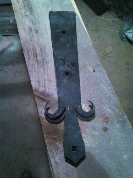

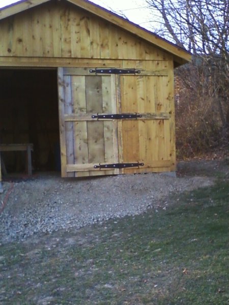

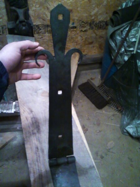

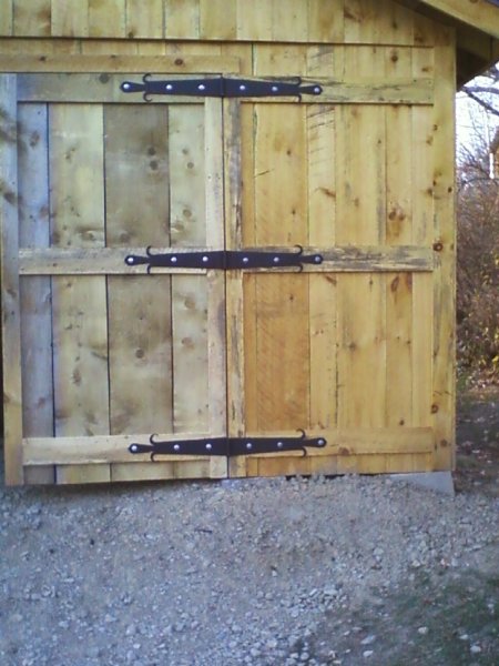

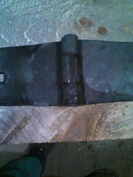

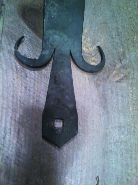

    381A0035.jpg 381A0036.jpg 381A0020.jpg 381A0021.jpg 381A0022.jpg 381A0023.jpg Here are the strap himges that I made for my blacksmith shop. I wanted it to be old school to match the post and beam construction that I built the shoo out of. The beams are from a barn built in 1874 that me and Scotty overkill tore down a few years back. The hinges opened up are about 4ft and are made out of 1/4"x4" flat stock. Everything was done on in the coal forge and the anvil.

    Thank you all for the compliments. I made 6 hinges, 3 for each door. All told I have approximately 40 hours start to finish.

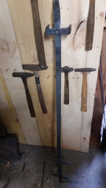

    Welcome blacksmith. Scotty has posted some pictures of repair work he has done on some pieces from his own collection, and I guess your shop is where the magic happens. Those hinges look great. The taper from the hinge end down to the decorative end are a nice touch. Do you have multiple pieces heating in the forge while you work at the anvil? I just worked up some 1/4" bar two weeks ago, and I ended up putting a few pieces in at a time so there was less down time between hammering.
    Here is a garden gate support I did for a neighbor to help with the post movement on a retaining wall. 1/4" stock, drifted holes and hot rivets peened over. I snuck a few hidden welds on the back for extra strength.
    The top bracket wrapped around the post.
    I'll be looking forward to more of your work. I use mostly small flat stock and rods for decorative pieces. I may do a sliding barn door for the laundry room. I have more ideas than time, unfortunately.
