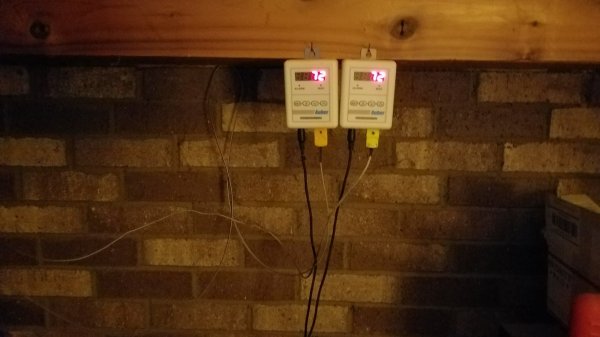

    This is where my stove is setting right now, pipe & stove top
    Cold stove, room temperature

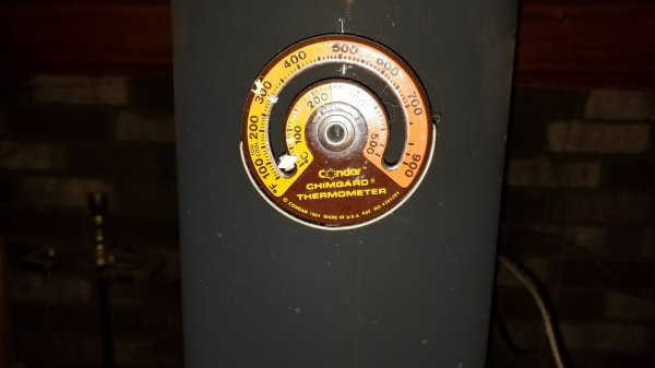

    Condar are the the best magnet thermometers I have used
    They make one for the pipe and one for the stovetop

    As HDRock stated, I believe that Condar makes the best magnet thermometers. We've had them from other places but they tended to be quite a bit off, including the ones we got (as a present) from Lehman's.
    The infrared thermometers should be really close so it is a good idea to use them occasionally to check the magnetic models. You can also check your stove with them to find out where the hot spots are. Then, of course, you can use them to find air leaks in your home so you can tighten up insulation.
