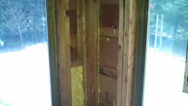

So, dear wife wants bead board wainscoting in there, and I'm having a REAL tough time figuring out how to do this and then trimming the windows. Should I run 3/8" drywall, then wainscot on top of that, or wainscot, then drywall above?
I've never done it myself Dave but have lived in 2 dif homes where it had been done. Both times, the wainscot was added on top of the sheetrock. I'd think you have an advantage of being able to put in any extra nailers, if needed, for the wainscot.
Yep. Although I'm not sure nailers will be needed, as the widest space is only about a foot. The drywall would act as a nice backer. Biggest problem is how to trim with the offset surfaces. The windows are 5' tall in an 8' room.

I can do 1/2" rock. I'll need to do ext. jambs, but not right now because these windows will be scrapped possibly as soon as next spring. Not sure how that'll need to be done when I put in the new windows, but that's the easy part. If painting, that'll hide the fillers, but I don't know if we'll be painting or staining the trim yet. BB (baseboard?) is still up in the air, but will probably be a stock item from HD. I don't feel like going to the trouble of making my own.
I don't want/like drywall as jambs, or do I misunderstand? I'll do a slim chair rail (maybe), but I still have the issue of the drywall and WS being on different planes. Thinking about it a little more....I could wainscot over the DW, chair rail, then drop the window/door trim on top of that similar to a traditional window trim out. Maybe wrap the jamb and wainscot with a corner trim piece? How would that be? Anyone see a problem? I'm gonna' end up with trim on top of trim on top of trim.

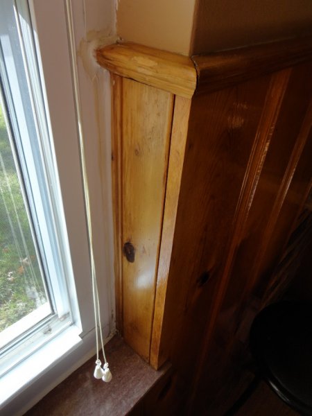

OK. Option 1: 1/2" rock. Trim the windows, then bring the bead board up to the trim...and finish with a chair rail. Option 2: 1/2" rock, put down bead board, then trim the window and shim the sides and top of the window trim with 1/4" behind the trim...and finish with a chair rail. Pick your poison.
This is how the wainscotting in my dining room is done, I'll be ripping it out in a month or so. When I rebuilt the bathroom and saw the backside of the wainscot, there was no drywall under it, it was nailed to furring strips that were nailed to studs. Not to say it's all done this way though.
I'm really liking door # one, although the macaroni Duct tape is tantalizing. I'll see it better once I start. It'll be after Christmas....maybe even after the new year. Thanks for the ideas.
