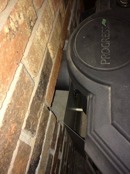

    Does anyone know of a way to install and control a stove pipe damper behind a brick wall? I can access the area behind the brick wall (mechanical room) it's just inconvenient to access when reloading the stove. I installed one last fall as a trial; I gain at least 2-3 hours burn time. My stove is rear vented sets ~2" from a brick wall so no room in front of the wall and I can't move the stove farther out due to my hearth.

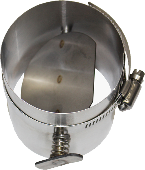

    I'm picturing something like this with an extended handle for more leverage and rod through the wall.

    This ^ ^ ^
    I need to put a damper on my insert stove. My plan was to make an extension rod that attaches to the damper handle and then maybe a small bracket/pivot screwed to the stone of the fireplace opening to hold the outer end of the rod. :yes:
    If you need to go through the brick with the damper rod, just get a long (18-24") masonry drill bit and a hammer drill, it'll only take ya about 10 minutes to poke a hole through there if you have a good bit.

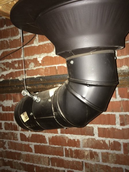

    Here is the pictures of what I'm working with. I tried a choke pull but it did not work. I'm liking the geared option.

    What a weird setup. So the brick is a façade (fake wall)? Can you slide the stove into the room enough to locate the damper right at the stove? Do you need that rear heat shield? Rather than a choke cable do you think a solid rod would work?

    Can you go horizontally from the first piece of pipe through the brick to the side of the chimney? Might be tough to drill that long hole but it would allow you to use a straight piece of rod, maybe 20" long for direct control of the damper.

    If you turn the pipe, or just move the damper so that the pivot rod is vertical, then you could drill a hole straight through the wall and attach an extension rod attached to the damper handle...it'll take some fabrication, and/or "repurposing" of some parts, but it shouldn't be too difficult to make it so that you have a push-pull rod to control the damper with. :yes:

    Highbeam it was originally a prefab fireplace with heat chamber connected to CHA complete with non operational thermostat control blower motor. I tore it out and installed a new chimney in the pre-existing location to maintain clearance. The hearth does not allow me to move it any father into the room. Removing the heat shield would not gain me any significant room.
    stuckinthemuck are you meaning instead of a horizontal 90* angle through the brick drill a 45* angle either up or to the side so I had a strait shot the the damper in existing location?
    brenndatomu im liking the combination idea from you and stuckinthemuck.

    No. I meant to move from existing location to the back of the stove and drill horizontally. Not sure how thick that would be.
