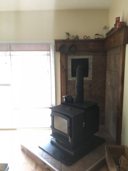

    single story house of typical construction- about $1000, maybe a bit less. my install is of double wall in the room , 1- 3ft+2 of the short adjustable ones ( no one had a 2ft double wall available in town) then the box(transition assembly) and insulated tripe wall 3- 4ft sections ( this where most of the cost ) and the roof penetration assembly plus a cap ( no screen but of a stacked bell shape keeps the birds out. The screens always plug up with creosote - nature of the burn, cold air causes condensation of hot gases at the exit. All came from Menards - course it went on sale after I had the install done- naturally. You do not want to mix mfg, they are not universally compatible.

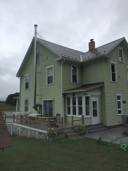

    30' of duravent triple wall. horizontal through the wall installation. I made a custom bracket to hold it far enough out from the house so I could clear the soffit. I also made some custom brackets to hold it in place on the way up, then finally a roof bracket. It's not pretty, but I don't care lol. I did all the work myself, from building the hearth to installing the stove and chimney. I really had no idea what I was doing, but it passed inspection and is still standing. I had roughly 1300$ into the chimlee pipes from HD. IMG_3371.JPG IMG_3367.JPG
