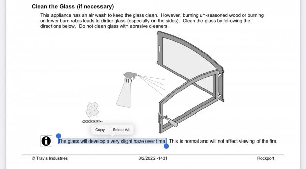

    #1 for using ash from the stove. Interestingly enough, the Travis manual says this..
