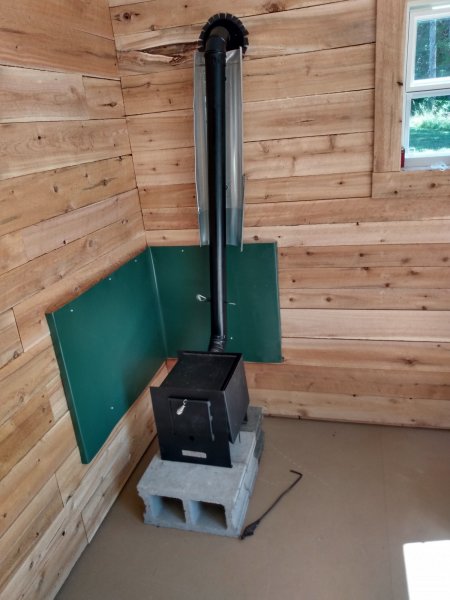

  8. yooperdave
    34,293
    212,410
    Yes, install the damper!
    I even put one in my fish shack for the small wood stove that has a 3" flue.
  9. Warner
    Warner
    Jun 19, 2017
    7,222
    46,448
    That
    that looks nice, do you use it for ice fishing?

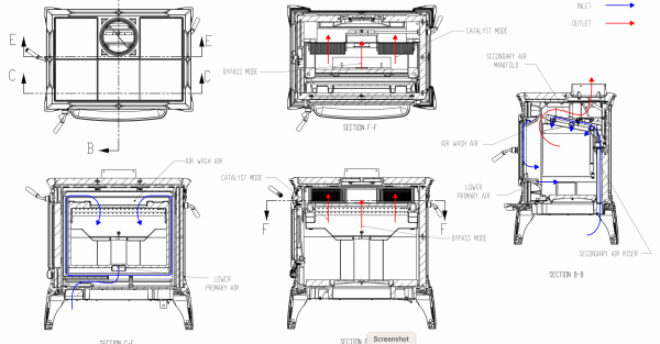

  14. Monadnock Monster
    Monadnock Monster
    Dec 21, 2022
    115
    544
    Perfect timing with this thread as I just decided today that I need a stove damper! My draw isn't too too excessive, just enough for me to decide I want to tame it down a little.
    Problem is that my piping is hard to access.... it's out the back of the stove and up a masonry chimney. Very little room to work.
    However, I have plenty of space to install one on the intake side. (My stove's plumbed with an outside air kit, and the hose for that is super accessible.)
    No reason I can't put a little damper on the intake side, right?
    Wildbill and brenndatomu like this.
  15. brenndatomu
    23,434
    150,548
    What stove is it? Some stoves have air sources outside of the OAK, so throttling the OAK would not have the desired affect in that scenario...not sure about a stove that gets 100% from the OAK...

  16. Monadnock Monster
    Monadnock Monster
    Dec 21, 2022
    115
    544
    Yah, sorry about that, guess I should get that in my signature....
    It's a Hearthstone Heritage. I've heard that some air is pulled in from a different source than just the OAK, but the diagrams aren't clear. Regardless, I don't need to reduce it very much
    I was playing around with it today and covered about 3/4 of the opening and was able to noticeably dampen the burn.
