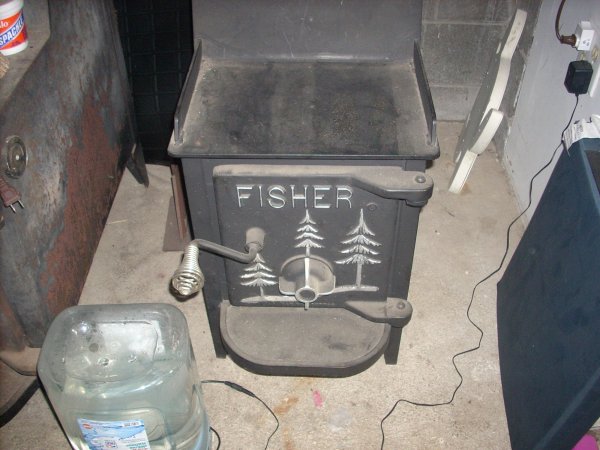

    Here's the perfect stove! Fisher Baby bear! I just happen to have one on hand!

    I’ll second the Fisher. We’re running a mama bear and can keep the house at a comfortable 80°.
    You can always open a window or the door.
    A hot fire is a clean fire, a cold fire will burn your house down.

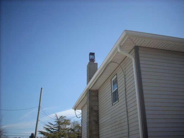

    I've been burning one for over 40 years! Stove temp, pipe temp, and chimney exhaust! "THATS NOT EFFICIENT"? Not to mention 80º in the house. Taken yesterday when it was 22º out. I haven't burn't 3 full cord of wood this year... Enuff said!
