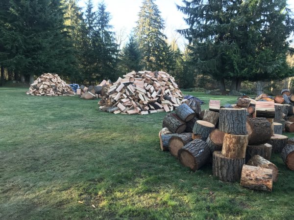

    9D157A7A-A176-46D1-A983-A5D6CF582D0B.jpeg D69D6280-B775-4B21-9E14-96EA025DF009.jpeg 8CC170E8-BEED-406F-A2F0-465C32DDE143.jpeg 45255273-F6D3-45FC-8BCC-620D33479069.jpeg 43631E4D-8B97-4BAD-A9D2-028532FDC791.jpeg The only way I can manage this much wood is to toss into 5 cord bulk piles on the ground and then top cover with 10’x20’ tarps for the winter. The plan is to sell all the piles.
    My shed is set and I have a fan blowing into a very green cord of cherry on the face. we are sitting at 45% relative humidity today so it’s perfect!
    Do you think my bulk piles will be ok with minimal rot and quality wood in 6 months when they’re gone? Am I doing it right? All Douglas fir. This is the best I can come up with for now.

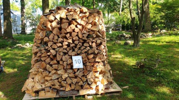

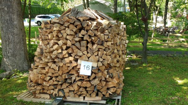

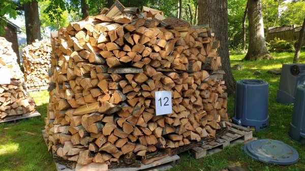

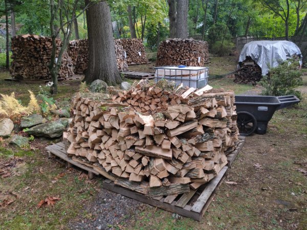

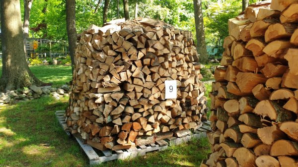

    I use 4 pallets under each of my holz hausens. It's a great way to store wood - takes up less space, self supporting, and gives you a place to hide shorties, uglies, etc.
    Here's a few pics of how I do it. And you can watch this video that I watched that got me going on building them. It's quite simple - lay down a ring of splits in a circle and then start stacking. If you start losing your inward angle place some more splits perpendicular so you recreate the angle.
    I have 21 stacks and only one fell down because I built it on a slope and didn't pay enough attention to the angle. All the other stacks have been great. With 4 pallets mine average about 8' in diameter and 6' in heigh and hold just over 2 cord.
    I cover the piles that I'm currently burning. The others I just leave uncovered so I can maximize wind exposure.
    If you leave a small gap in between the pallets you can make them slightly bigger and that small difference makes a huge difference in the amount of wood you can store. As you can see some of my stacks are noticeably smaller/larger compared to others.
    And I get all the pallets (and the wood for that matter) for free.
