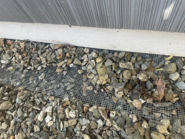

    Basically I pryed off the composite trim bottom board. Pull out the nails. Cut the hardware cloth to make 4 - 118” long pieces.

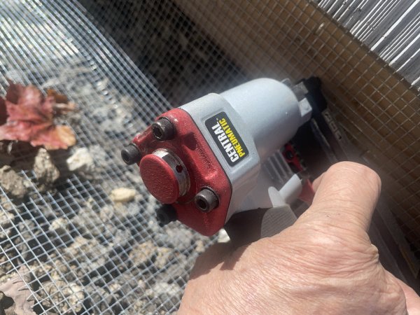

    Staple it up and screw the trim board back with deck screws which will hold better over the screen mesh.

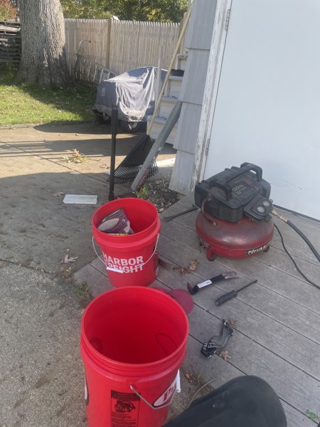

    Tools used

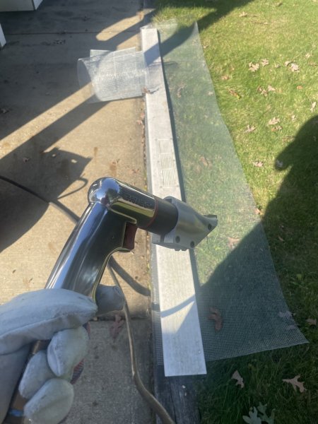

    Air powered shears
    Air powered stapler
    Pry Bar
    Hammer
    Phillips screw driver
    Battery Drill Driver with drill bit
    Battery Drill Driver with Phillips screw head

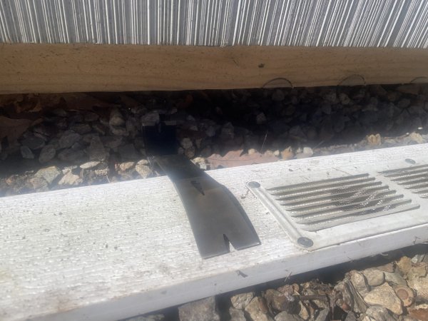

    Pic 02 - Pry off all bottom composite trim boards that were nailed on with a nail gun and pull nails out of sill board.

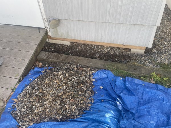

    Pic 03 - shovel out stones on a blue tarp
    Pic 04 - Tools Compressor pry bar etc
    Pic 05 - Cutting hardware cloth with air power shears

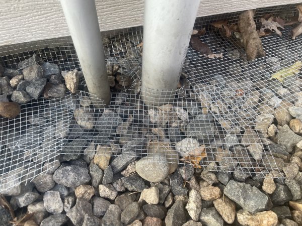

    Pic 06 - Bend & Air Staple Hardware Cloth to PT sill board to cover space between cider block and 7” of ground to prevent chipmunk entry
    Pic 07 - Cut additional piece of Hardware Cloth to go around electric wire pipes
    Pic 08 - Using wire cutters - Cut and bend Hcloth around electric pipes

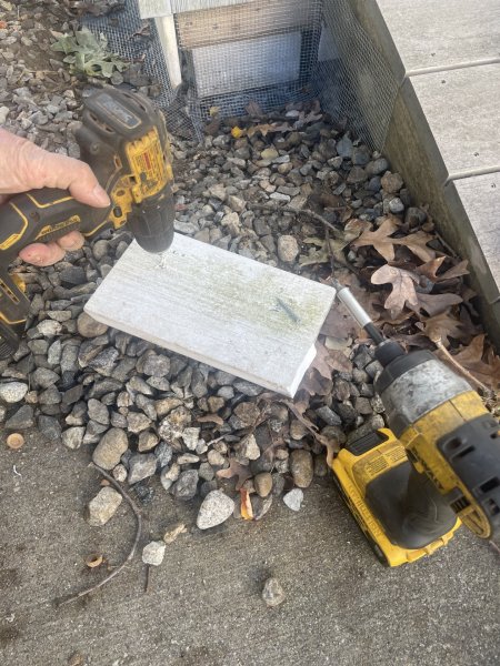

    Pic 09 - Drill pilot hole and using galvanized 1-5/8 deck screws to screw composite trim boards back up

    Pic 11 - Shovel stones back
