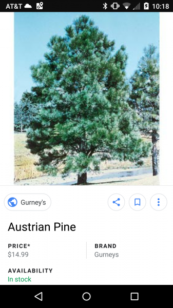

    Austrian pine, silly.

    Oh, you mean chimney fire starting wood....:whistle:
