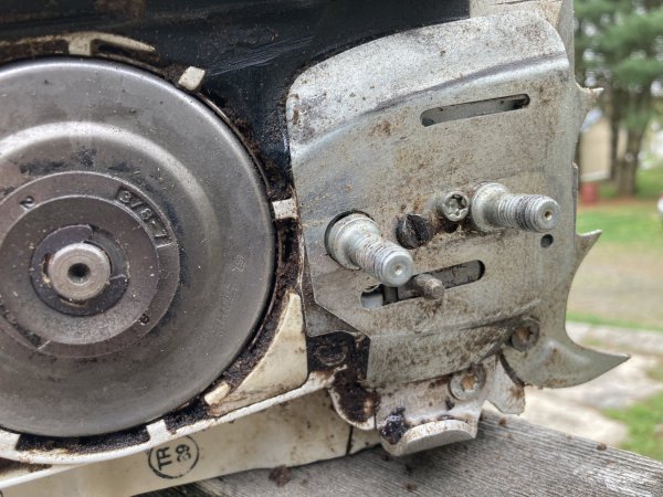

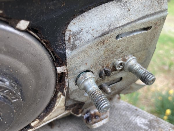

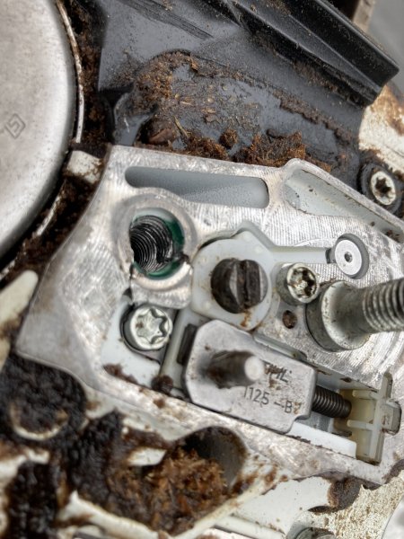

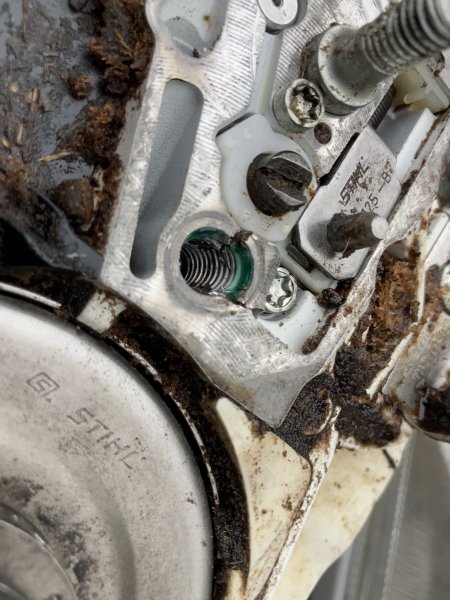

    So I pulled the stud. Things look worse than I had hoped. Not sure if anyone would attempt to helicoil that? I’ve never done the process myself but the cracking of the magnesium is probably a red flag. What say you all?
    May need a new crankcase instead of a repair.
    Anyone know a good Stihl mechanic? In the New England area might be nice :) Stihl dealers in my area dont exactly cause me to exude confidence. They’re sellers not mechanics.
    Maybe best to send it away to get ported and repaired at the same time? Anyone interested in a job? :)

    That’s a bummer! Any idea what caused that?
    farmer steve and jo191145 like this.

    oh absolutely. Cutting a leaner with another leaner on top of it. First cut I hit buried barbed wire. Moved up the trunk a little and pinched the bar. Grabbed another saw and cut above the 462. At that point the tree reversed barber chaired. It split in between the last two cuts dropping the tree and saw on my foot. In reality it was some stupid flustered moves on my part. One of those days where the powers that be tell you to pack up your gear, go home and try again when you get your ducks in a row. I did :)
    Trees I’m cutting right now aren’t that big so I began using my 550. Was a week later I decided to pull the chain off the 462 to sharpen it from the wire contact. It was then I noticed half the clutch cover missing. doh I had thought only my pride and foot had been hurt.

    Maybe some jb weld with the new bar stud might keep you from replacing the case?

    If I was to go the jb weld route, I would use loctite retaining compound 660. I used it on a 288 with a bum bar stud and it worked very well for it.
    I don't have that saw anymore but I never heard anything back from the member here about it.

    That was my first hope. Still going to attempt it but have less hope. Have a few tricks up my sleeve but if none of the hole is still concentric I think it’s a lost cause. We shall see.
