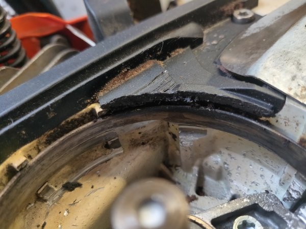

    Tree service buddy called me up and said "Hey man, the 500i you just did a tune up on.....the clutch area was smoking and the entire clutch drum is cockeyed....."
    My response was "Clutch needle bearing gone".....
    He came over 2 minutes later and this is what we found when we took the cover off.
    1. There was a friggin' ROCK in there. Not a piece of gravel. A ROCK.
    2. It destroyed the clutch needle bearing (I was found innocent of any fault)

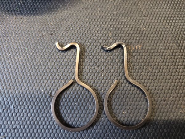

    3. 2 out of the 3 clutch retaining clips were sheared in half and were wrapped around the perimeter of the actual clutch (WTF!)
    4. The worm gear tip was sheared right off and does not engage the clutch drum.
    5. Washer and e-clip that hold the drum in place are gone.
    6. There is melted plastic all over the crankshaft. Tried rubbing it off with brake cleaner and a rag - no dice.
    Local dealers don't have the retaining clips nor the worm gear spring (they call it a spring but it's the part that hooks into the clutch drum) so I ordered those two on eBay and picked up the washer and needle bearing locally. That handy dandy screw kit came in handy - comes with 10 of the e-clips I need to replace this one.
    I am absolutely baffled as to how a rock that big got UNDER the clutch drum cover. How is that even possible??????? Do you think a worker did it on purpose???????????
    Oh btw the teeth showed NO signs of being hit by a rock. What the?

    That is crazy. I don't see how that could have gotten into the clutch unless it was apart first.

    They've been using the saw. No way that was in there when I had it. I ran it and there ain't no rocks like that anywhere near my garage. And I test on asphalt.

    My guess is a tooth picked it up and it rocketed into the clutch cover at high velocity and it found a way in.
  5. Chud
    Chud
    Aug 15, 2020
    6,488
    46,188
    NC
    Or a worker said It’s hot and I’m tired of cutting with a dull saw. Let’s see what happens when you drop a rock in the clutch.

    Or, just maybe it was laid on its side, clutch cover down, running, was picked up, carried on its side, cover down a rock some how found its place into the cover, lodged in the case, causing all the damage? Just a theory. we'll never know, saw's don't talk, lol

    Not sure how open that area is, but it may have fallen down in through the brake handle area

    I got the needle bearing, clutch clips, worm gear spring, and clutch drum washer installed today. The black plastic chain brake mechanism cover was a bit melted at 6 0'clock where it meets the top of the clutch drum. Had to scrape and sand that out. Also had to blow it out real nice with the compressor and got all the melted plastic bits out of there.
    Would you believe I put the original worm gear spring back on initially and the clutch drum wasn't engaging.....and I immediately though "No I didn't.........did I????" Dagnabit.
    So the springs on the clutch also took a hit and I forgot to order new springs. With the bar and chain on it moved ever so slightly. I will order new springs.

    You can see the oil pump got hit. Luckily it did not puncture it and the bar is getting oiled properly now.

    New worm gear spring (left) vs old (right).
    Melted plastic.
