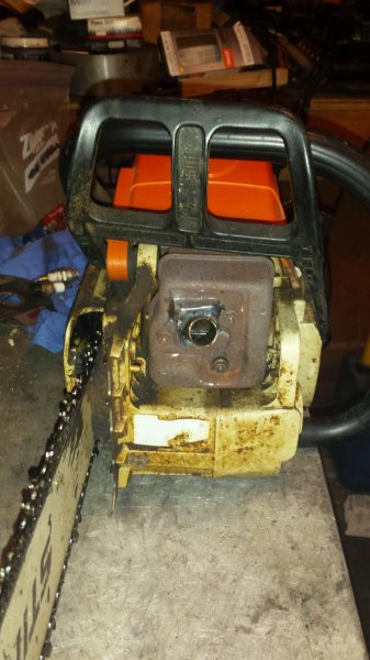

    Saw ran great till I ran it out of gas one time last summer (while it was in a cut), refueled it and started it, falls flat on its face under throttle....
    I tried everything.....checked the fuel tank vent bulb, changed the fuel filter, looked for holes/tears in the fuel line, changed the air filter, checked spark arrestor screen, changed the spark plug, tore carb down, cleaned and rebuilt......nothing works.....
    The factory carb has those dammed limiter screws that aren't removeable, so I cannot tear it the whole way down to inspect/clean them....that or the ignition are the only two things I didn't check. Saw has good vacuum/compression, so I've ruled out those possibilities. While I had the muffler off, I went ahead and did a port job/new outlet on it......
    I went ahead and ordered an adjustable aftermarket carburetor last evening......I'll see if that fixes the problem...

    From what little it ran, the saw sounds pretty wicked now...
    I didn't go too radical, but I did open up the muffler some, these things are choked down pretty bad on the backside of that spark arrestor plate.
