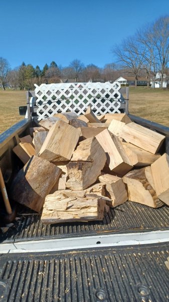

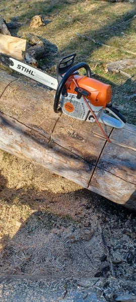

    Put it on today for a big dry ash. I knew there would be lots of noodling. Other than having to tighten it a few times I thought it cut very good. Will I buy another one? Maybe.

    It looks like the side plate is 55° according to the picture above and my on screen protractor. Pretty dang close to what I'm running with my deeper grind.

    farmer steve Did you like the chips it threw? Pretty smooth compared to round ground? I guess how it holds up and the ease of filing will tell you more with additional use:D.

  17. Eric VW
    24,446
    140,863
    Love that headache rack!!! Nailed it!!!
    :yes:
    :handshake:

    All I could afford after buying the hexa chain!:makeitrain"

    I thought it cut a bit smoother than regular chain. Not sure about the chips but the noodles were pretty big.
