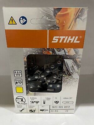

    I have a MS 400 C-M with a 20-inch bar and chain, 72 links, 3/8, .050". My wife bought it for me last February (2023). I ran a tank or so of fuel through it then got sick and haven't been able to run it since. My son and his buddy ran it a few times, I wanted it to be run, so they used it.
    When we bought the saw, we also bought a new/extra chain for it, I can't find the box though. I think it was 33RS. Does that sound right? I should be able to use it in a few weeks hopefully, still gotta heal up a little more first. I want to grab a few more chains for it.
    Thanks, NYH1.

    33 Rapid Super is excellent chain!

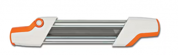

    Stopped by Runnings this afternoon to look a pistols. On my way out I grabbed one of these 2 in 1 files. Never used one before so I figured I'd give it a try.

    All I use for the last 3 years or more. I removed the raker files in all of mine because I tend to get heavy handed and make the chains a bit aggressive.

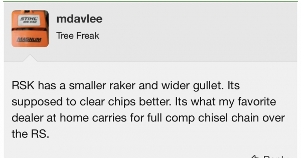

    Stihl RSK cuts fast for round grind and clears chips pretty good.

    So, would that be 33RSK?
    Thanks again, NYH1.

    Yes RS is full chisel faster cutting chain. Love running my 400 and has become my go to saw.

    Do the 33RS and 33RSK chains use the same files for sharping?

    Should as long as they’re both 3/8th.
    Searched the difference between the two and I doubt a firewooder could actually tell the difference back to back. Maybe if you’re cutting big softwoods? If you get loops of each, report back and let us know.

    Visually? They are pretty easy to distinguish IF you have seen examples of both.
    Performance? I think this is more of a cumulative effect of the Klassic cutter profile combined with the now no longer available "wide-nose" ES bar profile. Of course the advantages of a taller cutter profile and narrow raker are going to be enhanced in wood that favors long, wet, stringy chips.
