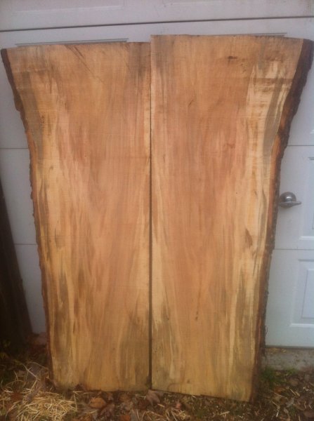

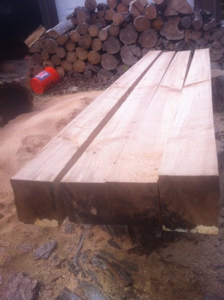

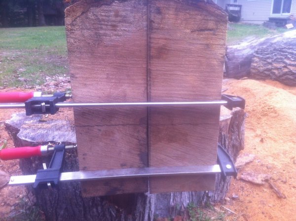

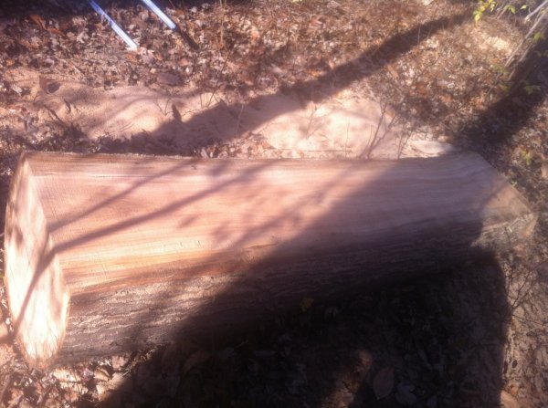

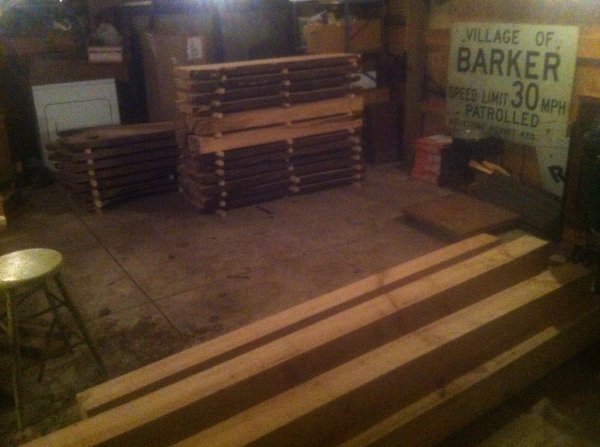

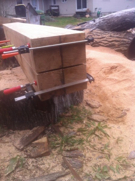

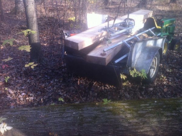

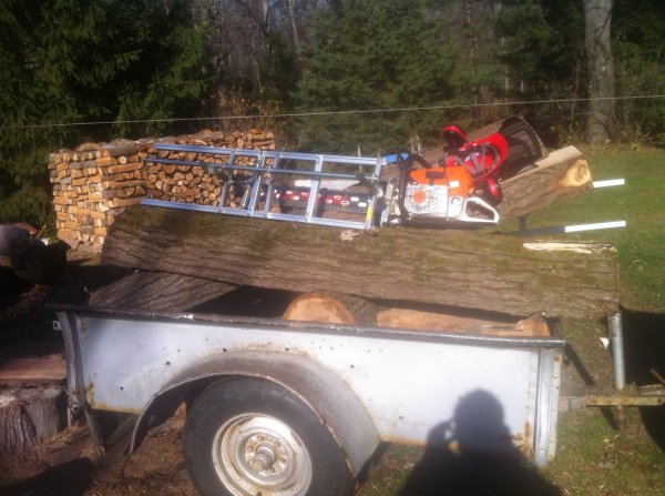

    I love mine - it feels lighter to me than the 660, and some of the new features really make it a pleasure to use. I use it almost exclusively for milling. It's definitely got the power to do what you want it to. However, if that project is the only thing you have planned for it, I'd take a real hard look at some other options. Shocking, I know. :loco: :crazy: Bandsaw mills are more accurate, and will turn a lot less of the log into sawdust. Chainsaw milling takes some practice, and it demands a Sharp Chain, which also requires some practice.
    For me, I have quite a few nice logs on the ground in my woods, and ma nature is delivering new ones all the time. I don't have a truck/tractor/atv capable of pulling them out and stacking them for a later time. So for me, it was a relatively cheap, DIY solution that allows me to get them out of the woods and turn them into lumber before they rot away.
    Chainsaw milling is Hard Work, but I find it extremely rewarding. Every cut I complete, it's like Christmas morning, and I'm opening up the gifts that ma nature has given me. :D
    I could probably ramble on and on all day about this stuff, but I'll try to cut it here. If you want to talk more, I'll be around. :)
    image21.jpg IMG_4130.JPG image22.jpg image18.jpg image19.jpg image20.jpg IMG_3946.JPG IMG_4177.JPG

    Only my back gets tired looking at your mill work Shawn Curry..... But my eyes love them slabs and cants:binoculars::yes:

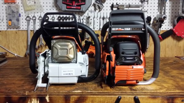

    Both of these saws are a great choice. The Husq 390xp and Stihl 661. Granted the 661 is an R model. But you can see the width difference even without the 3/4 wrap on the Stihl.

    Great pair-up pic' DexterDay! :yes:
    Could you spin the 390 just....a....smidge.....toward the 661?
    That pretty creamsickle is casting a little bit of a shadow on the Proper Swede.

    That's some awesome milling there Shawn! Those posts and thick slabs look awesome! I have a fair amount of property (~27 acres) and about 50 percent of it is covered in white and red oak. Long term I would like to get either a bandsaw or circular saw mill. The bandsaw mill would give me the least amount of waste but I like tinkering with old stuff, so I would be open to an older circular saw mill with a neat Detroit or Cummins powering it. How long does it take you to dry your lumber in your facility?

    Wow! A picture is worth a thousand words. I've run a 395 before in big oak and was extremely impressed, but have not run the 390. The 661 falls right in between the 390 and 395 in displacement I think. I like the looks of the Stihl better though.
    *Edit*
    After looking at the above photo, the Stihl looks much wider due to the way it is rotated relative to the Husqvarna. The bucking dog is making it look much wider. I think the pull starter cover is definitely wider on the Stihl though.

    I plan to give the stuff in my garage a few years. The general woodworking rule of thumb that I've heard is 1 inch per year air dried for hardwoods. I'm sure it varies by species too though. But the topic of drying lumber is an art and a science itself. I'm really just getting started myself, but I like to pass on what I've learned - which mostly comes from Will Malloff's "Chainsaw Lumbermaking", and members here. :)

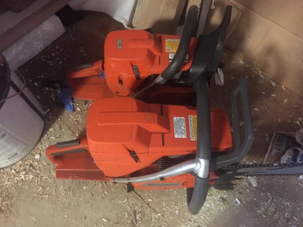

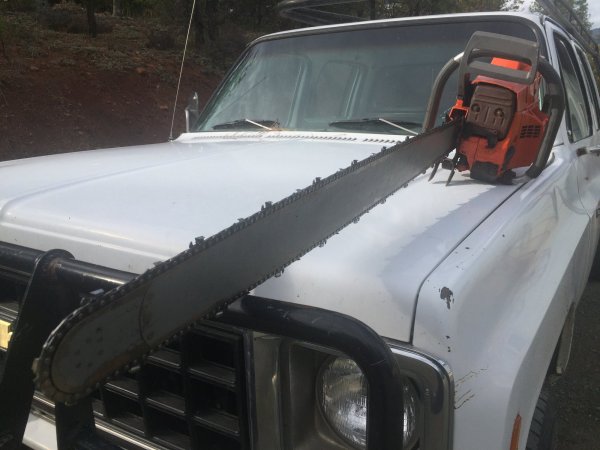

    I paid about that for my 661 with a 32" Tsumura RW bar, and I got this super nice 395xp with a 41" bar and new chain for less than half that...

    390 vs. 395. :eek:

    :bug::jaw:
    I'm not sure that bar is long enough, cgraham1 :rofl: :lol:

    A 395 for that price would make me forget about a 661 real quick. Lol!
