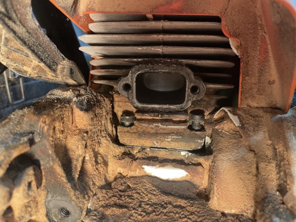

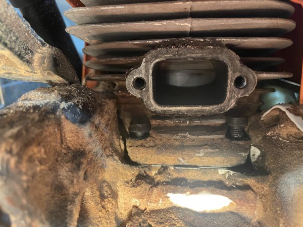

    I pulled the muffler quick and good news the p and C look good. Looks like an easy fix, but how the heck do I get at the bolts to tighten them?

    There should be 4 access holes starting at the top of the cylinder. Most likely torx head screws.
  8. KSPlainsman
    KSPlainsman
    Jul 26, 2022
    879
    4,489
    Kansas
    Glad it's an easy fix, but I haven't seen bolts back out that much on a cylinder before. That's pretty wild.

    I’d pull the loose ones out, one at a time, loctite and re install just snug to a little more than snug. Then pull the back two, one at a time and loctite and reinstall, a little more than snug
    Then cross pattern tighten incrementally. With a T handle, until the shaft starts to twist. I’m sure there is a torque value you could find if you want to go with thst

    Not to cause you more work, but trying to prevent issues down the road. I’d be concerned about sawdust getting sucked into the base gasket area with only a metal base gasket. If it were me I would clean it up as good as I could, remove the cylinder, clean the area, and then bolt it back down

    You can pretty much tighten them all you can get out of a T handle. They are M6 where most others are M5
