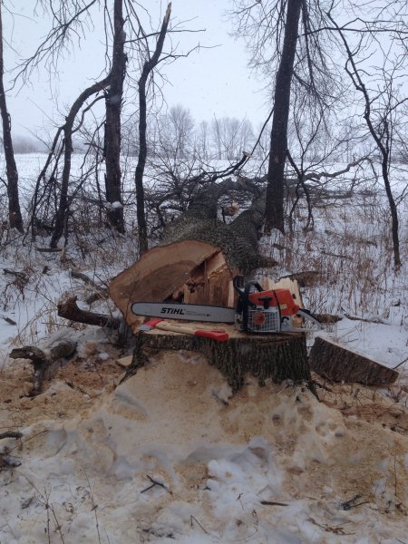

The 460 DP cover will fit on your 461. Somewhere in the neighborhood of 75% or so of the 460 & 461 are interchangeable, and the muffler cover is part of that. I can't tell you from experience if the DP cover makes a noticeable difference though. I had a 461 for awhile and spent several days dropping and bucking large trees with it including some ash trees that were in the 3' DBH range. Because of that I spent a lot of time with the 25" bar buried and that bone stock 461 never missed a beat, tank after tank. Frankly, I never really wished it had more power - in a word, it was perfect. Just because I do sip the Kool Aid occasionally I did get a DP muffler cover. I installed it and re-tuned, but never actually ran it before trading the saw off. This isn't the biggest tree my 461 went up against, but still a quality gratuitous Stihl shot!
