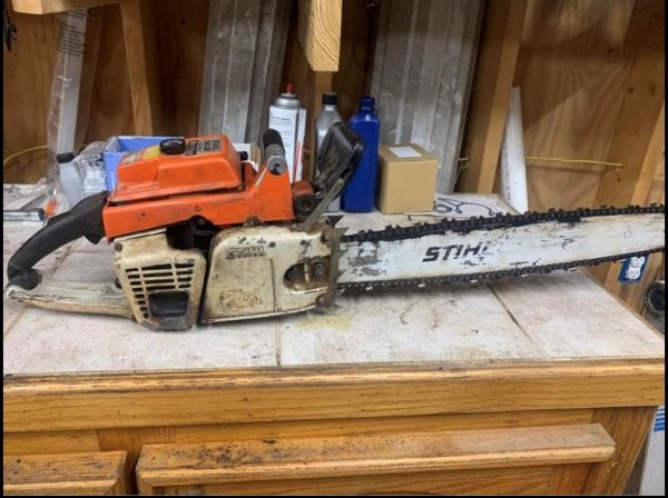

    I saw a Stihl 041 for sale locally "for parts or repair" for a listed price of $125. The description goes on to say "did have it running a few months ago. Haven't tried it. Kill switch doesn't work if I remember correctly and choke knob is busted".
    I have a Stihl 026 with a 16" bar but was interested in having something a little larger to cut logs larger than 14" diameter and don't have a ton of cash to spare. Thoughts on if this would be worth pursuing? Originally I was going to save some money up and try to find a used 036 or something similar eventually but just glanced through the local ads and saw this. Just wondering if it was worth it to offer $100 and see what happens. From what I've read the 041's do have a large displacement but run slower RPM's than what is typical, and tend to be heavy.

    I’d pass, save your money and wait for something better. Before I bought my 029 Super, I went to check out an old 041. It was in decent shape and ran well enough. The seller had a pile of logs there and I took a few cuts with it. Heavy is right. For the power to weight ratio I wouldn’t want to lug that around all day.
