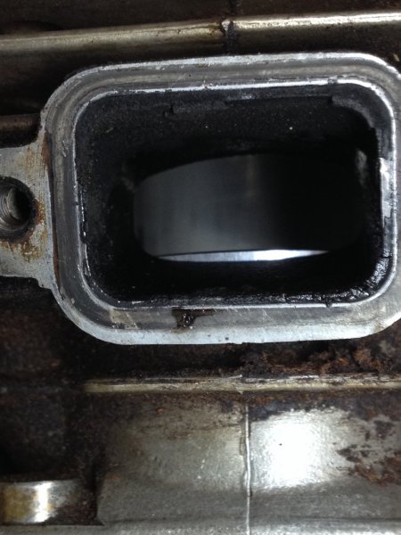

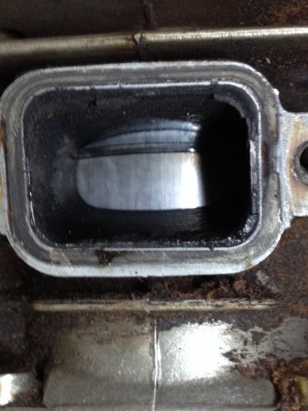

  15. reelcrzy
    reelcrzy
    Jan 10, 2014
    300
    577
    Plymouth MA.
    image.jpg image.jpg Well the coil shows delivered when I track it online but it didn't show up today. Hopefully tomorrow. Here are the pics of the piston and cyl.

  17. WV Mountaineer
    WV Mountaineer
    Aug 25, 2015
    200
    591
    Princeton, WV
    That piston looks great. God Bless
    reelcrzy, clemsonfor and Barcroftb like this.
  18. Barcroftb
    Barcroftb
    Sep 30, 2015
    3,076
    17,849
    The Mitten
    Yes that is a nice slug and jug! Once you get it started you will have a good runner for a great price!
