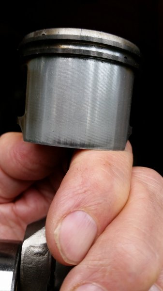

    Post a pic of the parts you have. Especially the sides of the piston. Low compression could indeed cause the hot restart issue you describe but it would generally be accompanied by rough idle/stalling, difficulty tuning and a noticeable lack of power. The 029S is no ball of fire in stock form so the lack of power would have been pretty noticeable unless you were cutting small wood only.

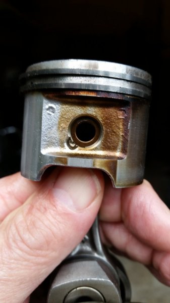

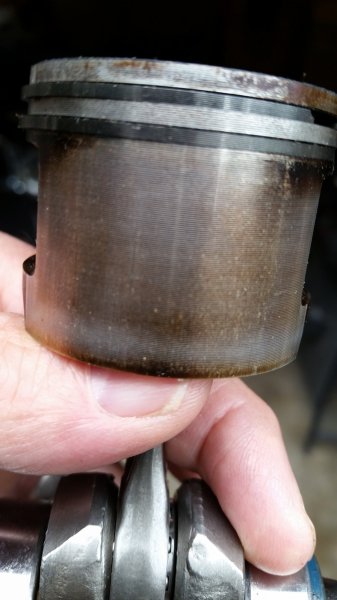

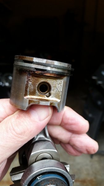

    Thanks for the responses. Pics are attached. Replaced with another Farm Boss - MS271. Qualification - I just retired and never messed with small engines prior to about a month ago when I decided to mess with my tiller. Rebuilt the carb and it now purrs. So, no I didn't try to diagnose the issue outside of cleaning the air filter. Just took it to the dealer.
    So, what is your opinion? Is the piston toast?

    That piston looks to be in great shape. I would put some new rings on it and some new crank seals since you have it apart. By what the piston looks like I assuming the cylinder looks good also.
    You could still have a carb problem but will not know until you get it back together.

    I agree that piston looks good. Could be an air leak somewhere else. Intake boot, seals, bearings, impulse line, etc. Or more likely it could be a carb issue.
    It may be time to pick a different dealer though. At the minimum they misdiagnosed your problem. Worst case scenario they purposely jacked up the repair price to sell you a new saw. I've seen this happen before with friends and family.

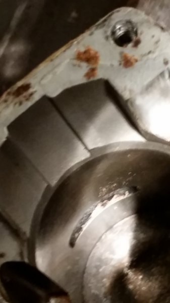

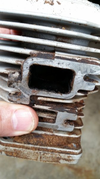

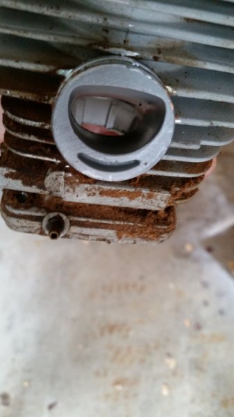

    OK. I pulled the paperwork on the old saw and I guess I mis-stated the dealer diagnosis. Sorry about that. They reported " intake manifold was leaking causing lean running conditions. Scored wall. Could possibly hone cylinder but best bet is to replace it." I'd swear they said piston over the phone.
    It's hard to get a good pic of the cylinder but there are some vertical lines at the top of the exhraust side of the cylinder. it feels smooth when I run my finger across it though.

    I agree with that the piston will work for sure, as stated new rings and seals....

    Manifold will need to be pressure tested to confirm one way or the other. You could replace it if you have no means to confirm the dealer diagnosis.
    Don't be afraid to take some light sandpaper or scotchbrite to the rough spots inside the cylinder. You won't hurt it a bit smoothing it out by hand.

    Just from the looks of the piston I doubt that the cylinder has any serious damage to it. Like MasterMech said do not be afraid to use some fine grade sandpaper or scotchbrite to smooth out the cylinder wall.
    The fact that you cannot feel the vertical lines on the cylinder with your finger tells me there is nothing wrong with the cylinder.
    If the lines were deep above the exhaust port you would have lost some compression and that does not sound like the case to me.
    Like BarcroftB said time to look for another dealer.
