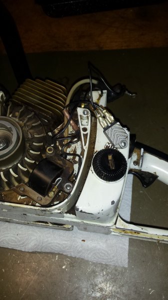

    Hey guys,
    Found a deal on an old 028 and picked it up last Friday. She's in pretty good shape - top end is spotless and pulling 160psi. Dumped some old gas from the tank and added fresh mix - started up right away and was running strong for a minute or two, then as it idled down, it stopped abruptly then would not fire again.

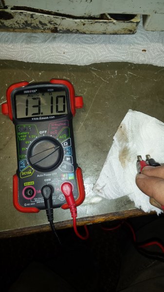

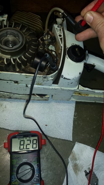

    Checked spark and the saw has lost spark completely. Removed the recoil and the saw has been updated with the ignition module from the old points/condenser. Trying to troubleshoot the coil and ignition module, but I'm an idiot with electronics. My 12 year old boy is 100x better than me with electronics, so I had him start to troubleshoot the system with his multimeter. I've attached some photos, but not sure what values I'm shooting for to see if the coil or module (or both!) are bad. Anyone good with electronics and can offer some suggestions on how/what to test and what value to look for, I'd appreciate any help, and feel free to explain it to me like I'm a child! I've attached a photo of testing the module with the resistance value, and testing the plug boot to the coil. Thanks in advance! Cheers!

    Your numbers sound right, what does the coil alone measure? Are all the contact points clean and free from shorting somewhere (rubbing somewhere on the case?)

    I'll check coil alone and let you know. I removed all leads and cleaned them and the contact points. There was a small area of exposed wire on the kill switch wire, just up from the control lever. Wire still showed continuity and I covered with electrical tape and still no spark. That was the only noticeable problem. Thanks! Cheers!
