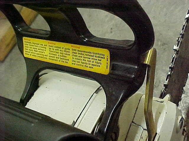

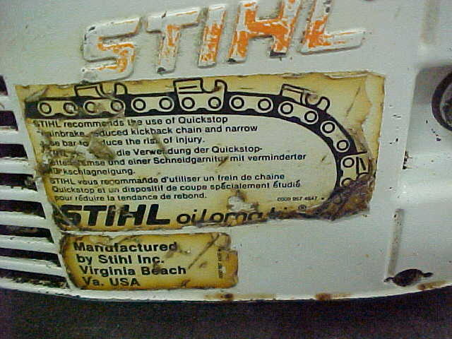

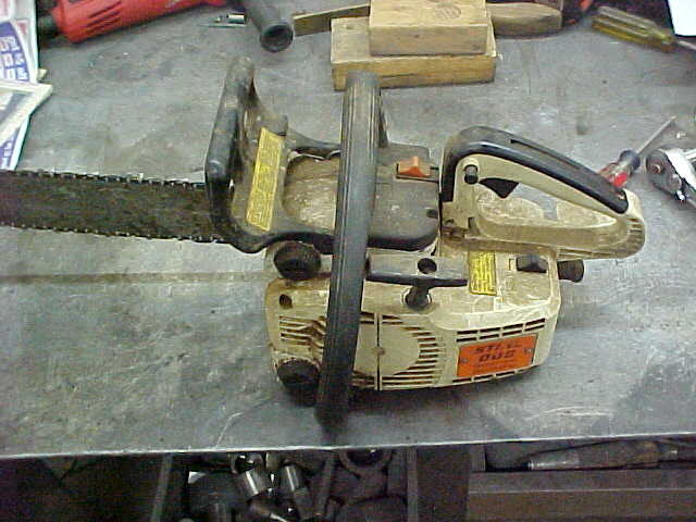

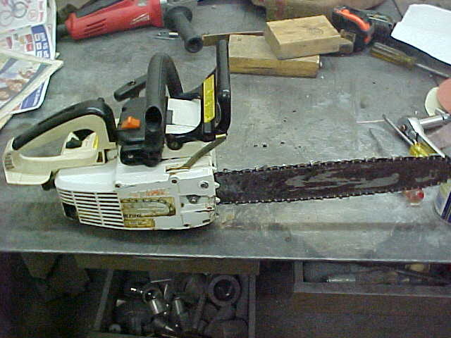

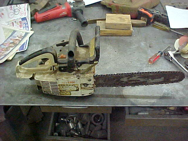

    Was at a garage sale this summer and picked this up for $20.00
    Dirty but was complete and didn't look like it was used too much. Seemed to pull decent but owner said it hadn't run in years. Had some time today so I pulled it out to see if I could get it running or if it was just a parts saw.
    Gave it a quick clean and found I had spark. Compression was fine so 2 outta 3 Gas smelled a little bad so drained it and flushed it out. Pulled the carb and tore it down. Not too bad but a little crud here and there. Lines weren't gummy so I put back together. Poured a little fuel in it and it popped. Pulled again and it ran! Little tweaking on the carb and I have a runner.
    Good to have a backup again.

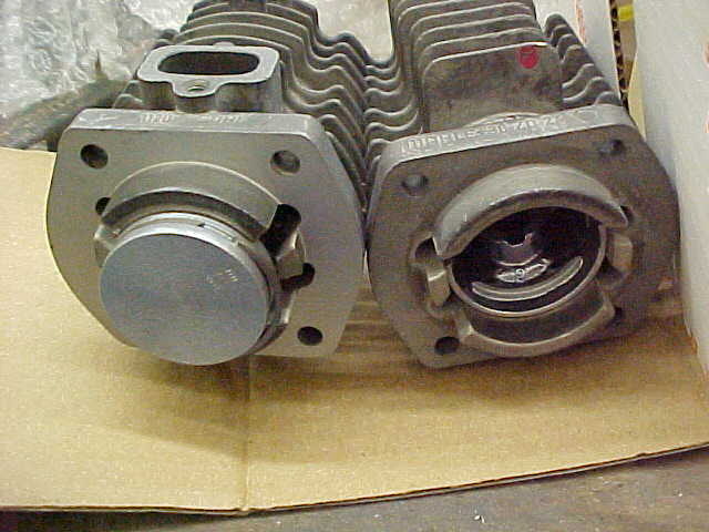

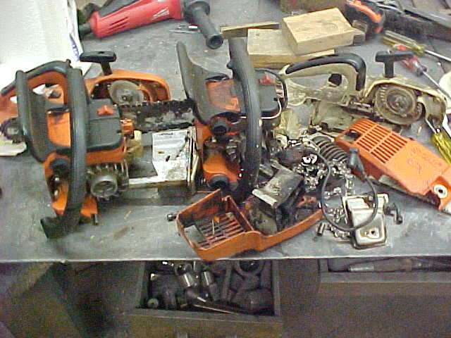

    I was also given another 009 in pieces a while back I put it with my original but it had a junk cylinder as well. Dug those out after having success with the other one.
    These will take a little more work :D

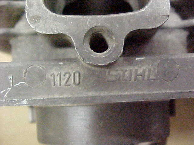

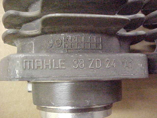

    I had picked up a box of NOS Stihl parts a while back and remembered some jugs were in there. They are 36mm but they are 4 bolt for the newer style(gray) saws. My old orange ones are 2 bolt. Does anyone have a resource online to decode Stihl part numbers to verify what they are for? Here are a few pics.
    Box says 1120-020-1216
    As you can see cast numbers are 38 ZD 24 Stihl 1120 I'm guessing 009 010 011 are probable users of these. I'd like to find an older 2 bolt 009 so I could get my "memory" saw going again. Open to trades or such.
    The numbers on the box of the cylinder I need are 1120-020-1200
