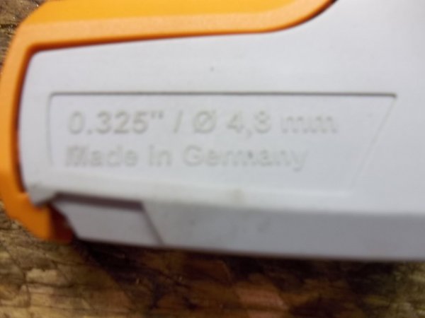

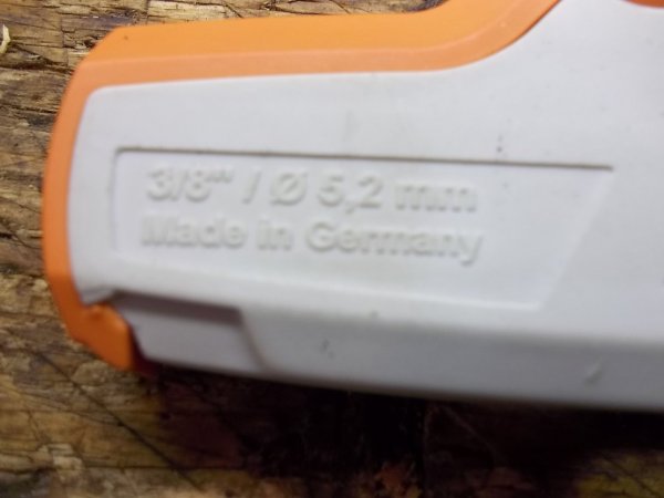

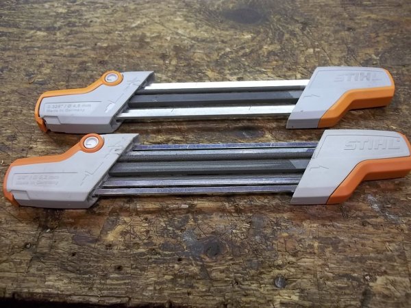

    I bought one of these sharpeners a year ago but could not make it work on skip tooth chain until I seen this video. Now I'm sold on the tool and have one for each saw 3/8 and .325.
    The two file holders.
    The 3/8 for the 562 Husky.
    The .325 for the small 439 husky.
    I have vice that can be attached to the wood splitter so I will be able to do a good job of filing the chain should it get rocked out in the bush!
    This combination of 2in1 tool and the vice makes a real difference in my chain sharpening.
