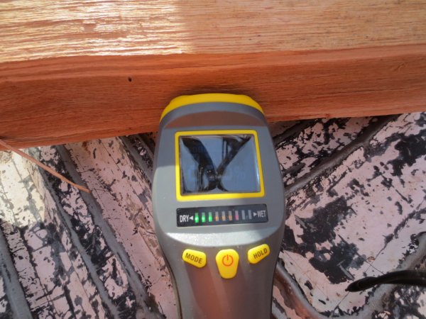

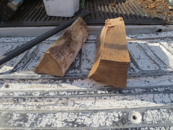

    I cur and split them right away and since they were in the woods i left them to dry...one mounded the other stacked on sleepers. I was there to clean her gutters the other day and grabbed an average split to check internal moisture content. One was 22% the other 27%. I thought they'd be drier. The waiting game continues.
    Left split was 22%, right was 27% Pics are of splits PRIOR to splitting to check MC.

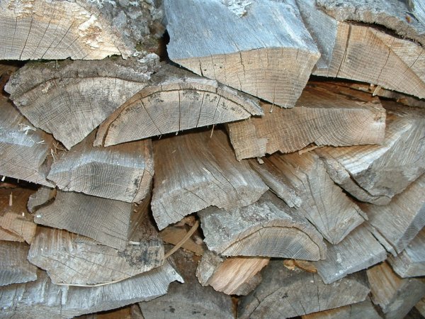

    That is not surprising. Wood doesn't start to dry until it is split.
    To dry faster consider splitting in thinner pieces that resemble boards. This is about 6-7 months DSCF0014.JPG since split, drying nicely.

    In the shade when leaves on trees decent breeze does blow through there. Can i drop them at your place and use your field Joe? How much is your wood storage fee? Wish i had a full sun exposure.
    The wood was split a year ago, stacked and mounded off ground. No top cover. Im in no rush. Ill pull them this Winter and stack in my PA.
