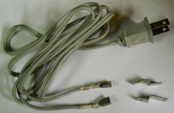

    I would try removing the auger motor & auger from the stove. Since it's been sitting for a while, pellets may just be jammed/expanded slightly and stopping the auger from turning. That way, you know the auger tube and auger are completely clean. Use the power adapter cord Jay mentioned (make out of an old lamp cord) and test motor while out of the stove.
    If the motor spins OK after cleaning &/or removal from stove, you may have fried the board. Most everyone here has a real good quality surge protector on their stoves to eliminate just that expensive problem.
    Here's what a lot of us have made just for testing motors both on and off the stove:
    jtakeman and Birddog91 like this.
