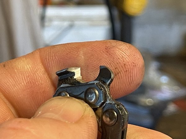

  5. Eric Wanderweg
    6,971
    53,429
    The chain I rocked yesterday needed a ton of work, and it was already worked pretty well from converting it to square file from round. I ended up going buck wild with a Dremel to clear out the gullets. By the time I got the carnage on the top plates to disappear, they were considerably shorter. I figure this could be a good chain to experiment with.
