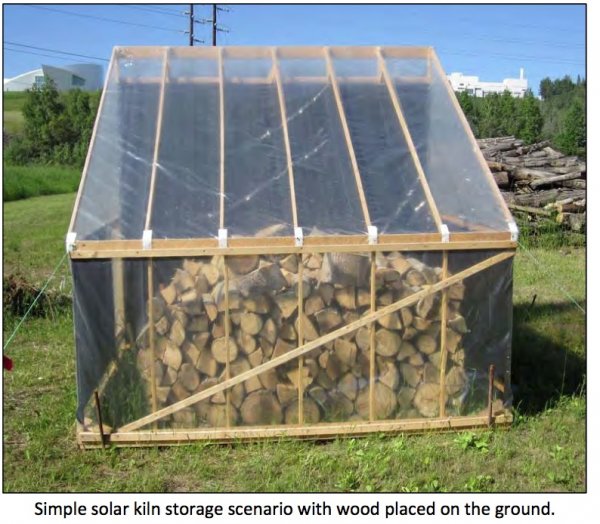

    I don't think their Solar kiln had a layer of plastic on the ground for a vapor barrier,m & no pallet . Wood was right on the ground
    Augie's has a layer on the ground, that hast to help.

    13,177
    Also looks like the top back could be open. Augie's design is completely sealed except for weep holes to let out the condensation.

    Eastern Minnesota
    yeah I going to comment on the same thing. No air circulation. Most effective kilns need warm air movement....that's the whole concept.

    Need to get Augie here & give his ideas on their solar kiln.
    I like the construction but not the wood on the ground
