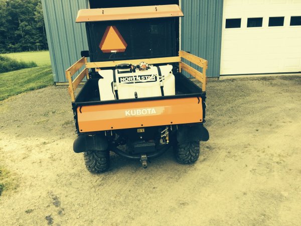

    IMG_0285.jpeg I use a 26 gallon unit from Northern Tool for my food plots. I put in the back of my RTV. It has a boomless 12’ sprayer and a hand held. I paid around $200 10 years or so ago.
