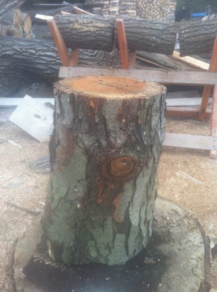

    A few recent splitting tool topics have gone in this direction, and there's been a ton of good info there. Plus it seems like there's a lot of injuries happening lately. So I thought this could be a good topic.

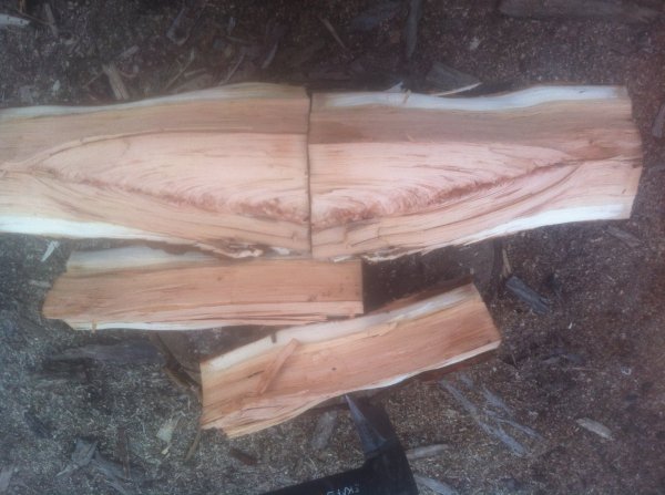

    For me its more about accuracy than power. I'll try to 'read' the round to get an idea about what the grain is doing. If its nice and straight you can hit it wherever you want, but if it curves or branches its best to find the 'seams' and split along those.
    First round I popped open this year - cherry of course... There's a seam in these crotch pieces, basically right down the heart center. So I find its actually much easier to split the "pants" in half, even in a larger example than this one. This applies to any size knot as well. I like to attack from the smallest branch on the branched side.

    If you cut the round shorter as needed to get that knot near an end then split from that end it makes it go much easier. It does take thinking ahead when you are bucking to avoid wasting a lot of wood that way. In your example picture, if you wanted smaller splits you could take off the part that is away from the knot to reduce it even further. In your picture that would be a 1/3, 2/3 splitting location.

    Yep, it all starts with cutting it up the right way too. Its takes a lot more power if you don't saw through the "armpit".
    The first pic is a little misleading - it's actually a crotch with the branches pointing down - the knot was insignificant.
