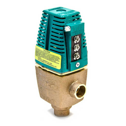

    I was considering adding a hydronic heat loop in the basement going to a coil/fan unit.
    I didn't want to tie into the existing supply lines at the boiler and re-work it. I found a three way zone valve that I could swap out with the regular zone valve. I believe check valves would have to be installed on the zones on the returns. It would be a simple solution for my application.
    BCB likes this.

    I'm pretty sure those valves are what they used on the This Old House clip I saw. I can't find the clip though. It was an all wireless set up.
