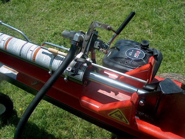

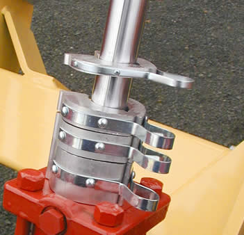

    Don't know the design of your splitter but slip in stops can be made fairly easily. I never cared for cylinder Rod clip[ for the fear of rod scratching and seal damage. On mine it was pretty easy to do and I have 17, 24 and 30 inch stops.

    Had to look at your build, I see that goes on the bottom .
    My wedge slides between the two channels
    What is this cylinder Rod clip you speak of ?
    I'm thinking 2 piece wood block , laminated face grain, hole down the middle to fit shaft, hinged on 1 side (top or bot) studs in slots w nuts or big azz wing nuts , or just a clamp across toe top
    EDIT: Or just cut a 8"block of sugar maple ,slot across the grain and slop over shaft

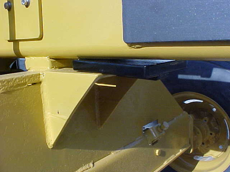

    An adjustable stroke limiter is easy to build.

    :thumbs: You got more pics ?
    So, that's just held on with band clamps ?
    Oh , I see what it is
    JD Guy and Stinny like this.

    These are cylinder rod clips. You just add them for limiting the stroke. Any ag store/dealer will have them.

    You beat me to it Kevin! They are easy to use, and easy on easy off if you need to.:thumbs:

    Thanks , good to know what they are ,but
    That doesn't sound real good if it's going to damage something
    BillinTX set up seems to be a safe bet

    We used them in farming all the time for young kids running tillage equipment so they wouldn't go too deep. For the most part they don't do any damage as they are soft metal riding on the chrome shaft. It's just one of those things I try to avoid if possible. If your splitter has a lot of vibration it may mess with the chrome on the shaft over time.

    The concern with limiting the stroke on most splitters is the end of the cylinder rod. They aren't meant to have much force applied in reverse. On mine, it'll shear the relatively small retaining pin easily. Other problems have arising from stopping the wedge at its base as it creates a twisting/shearing force at the point where the rod attaches to the wedge. I've see the welds fail and in one case, the threaded nose of the cylinder rod snapped.
    Bill's setup is pretty ingenious. Clean up the design a bit (cosmetically) and I bet it'd be pretty marketable.
