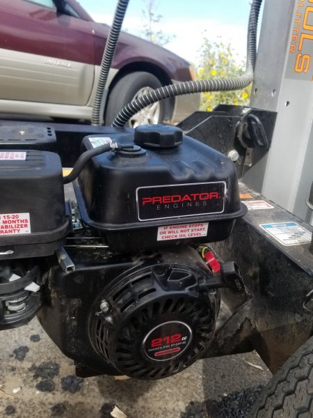

    After lending it to a neighbor at the end of last year, I had a lot of work to do to get the splitter up and running. He dropped it in my driveway with a flat tire when he was done with it. I did not have time to move it right away, so after backing into it with my tow ball it needed a new motor or some repairs to the old one. I decided to go the easy route and put a predator motor on the DHT 22 ton splitter. The swap went pretty easy and I was able to split a couple rounds that same night.

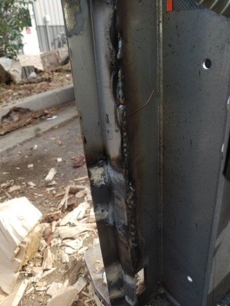

    On the second round one of the side track guides blew off. I guess he had left a broken pin in the track and the wedge hit it and broke the weld off down the whole track. After much heating and hammering and prying, I got it close enough to weld back on and I am back in business. Then one of the rocker arms fell off my new predator motor!! Once I figured out what had happened it was a quick fix and up and running again. Disappointing that the rocker arms are held in with C-Clips! Worked up a decent size pile so far today and all is right in the world again.
    Please do not laugh at my awful welding skills. I was using a small lincoln wire feed and it would pop the breaker after about 1 inch of welding.

    Bottom line welds need to hold ... Looks are secondary at best!
    Looks like its working so:yes:

    Next time you are forced into welding thick metal with a small welder try pre heating it. Even a propane torch can help a lot. Well at least your neighbor brought it back, some don't even go that far.

    Sorry about the motor and guide track. I think it is a good deal to have cheap replacement motors like the predator available. It is just as good as the smaller Kohler motors. Hope it serves you well. Pre heat on the weld as Screwloose recommended is a good idea. As for the welds....if they hold up, they were good! Glad you are back underway!

    The clips are if I remember, on the hemi!!!!!:dex: The regular true honda clones don't use them.
    That's the more desirable engine. The regular clones have a hexagonal valve cover the hemi is square if I remember.
    Never heard of one coming off.
    Can't see your welds covered in slag!
