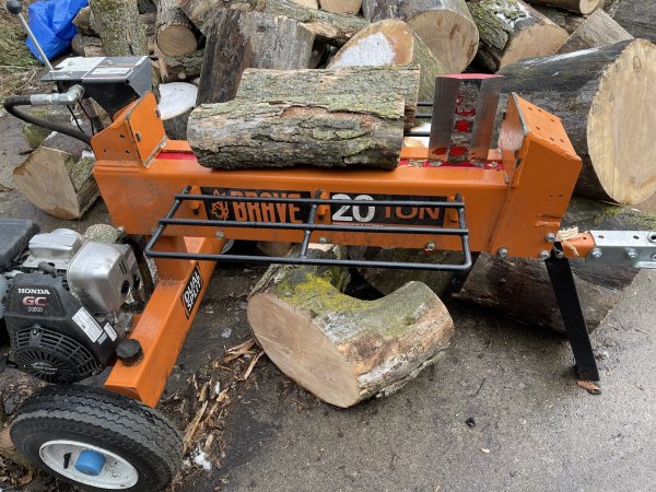

    I have a bunch of experience with a similar unit in brave dual split flavor. EBA8D32A-D682-4AE6-AC40-AE57D1354B44.jpeg
    I loved it for ash or other straight grain wood in the 4-12” range. With wood that size it could easily keep 2-3 people busy. I didn’t like it so much for wood bigger than around 12”. What would happen is it would knife through the bottom 3/4 of the round leaving the top virtually unsplit. This required flipping the round over to the other side of the wedge and running the cycle in the opposite direction to finish. I ran a buddy’s harbor freight dual split splitter and it was much the same. It didn’t seem as well built but he had had no problem with it.
    If I were to get another dual split type splitter (and I’m seriously considering it in the future) I would save up until I had the extra to buy a split fire:
    HYDRAULIC LOG SPLITTER with Hydraulic Log Lifter
    To me it’s worth it to have all of the shortcomings of the brave/predator dual split units solved. Plus they are the originators of this type of log splitter so they have the most experience building them.
    Having said all that you would probably get lots of great use out of the predator splitter as long as you weren’t splitting wood larger than 12-14”.
