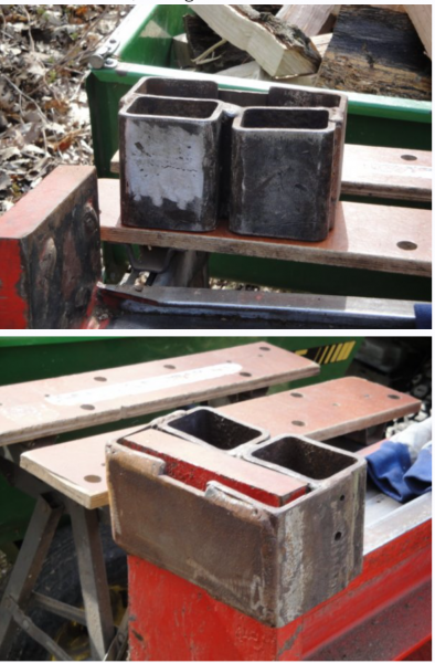

  13. Horkn
    28,549
    161,536
    Who likes elm
    This one which is similar to t.jeff veal's, it's actually Erik B's Screenshot_20211228-215646(1).png
    I like this because it's a slip on. Put it on when needed, pull it off when not.

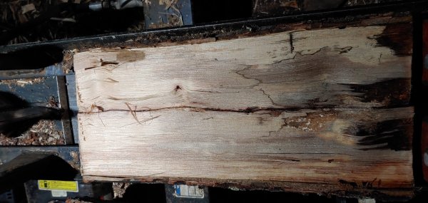

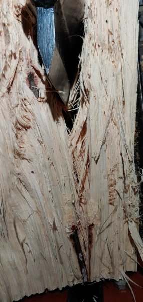

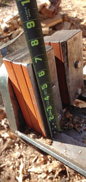

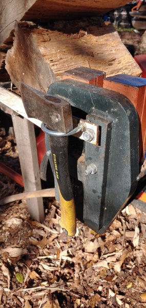

  14. T.Jeff Veal
    27,053
    169,524
    I tried tubing at first, but it bent. It was bolted on, since I don't have a welder. Erik B's is nice, though, easy on/off.
    I have only had to take ours off once or twice, for a customer that wants 24-25" long splits.
    Either design works great. We have had some hickory that came from the same place, some stringy, some straight grained. 0825202118.jpg 0825202119.jpg

  15. Erik B
    Erik B
    May 12, 2015
    5,420
    37,042
    Western Wisconsin
    The 'tube' pieces on the one that I made came from upright stakes on a logging truck. Something had happened to them as they were bent but I got a couple small straight pieces from it for my build.

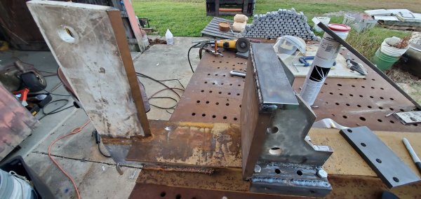

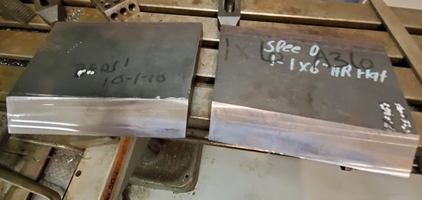

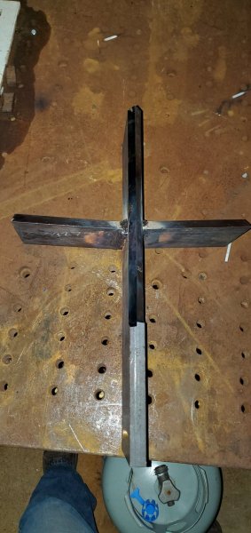

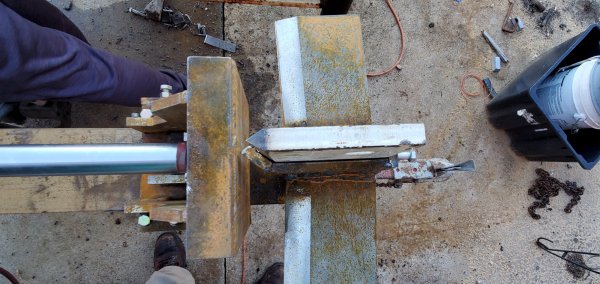

  16. Casper
    Casper
    Jan 25, 2017
    1,707
    9,648
    I spent a ton of time on "free" steel making a second beam to swap out with the factory beam. I machined it, welded and assembled a cutting edge with a slip over 4 way. It worked great, right to to the point a kotty piece twisted it. I started a new wedge and different beam design. The I-beam I used worked, but it flexed a little. New design is boxed tubing with an internal spine welded in. Will Posted pics when I get around to finishing. I will be able to reuse the pusher and that had the most time involved, especially after dropping the cylinder attach points. It was too high.
    Here's a few pics and a video pre-fail.
    20201003_193002.jpg 20201003_191848.jpg 20201003_191854.jpg 20201002_184410.jpg 20201002_184355.jpg 20201005_181407.jpg
    Post fail...
    New wedge made from A36 plate:
