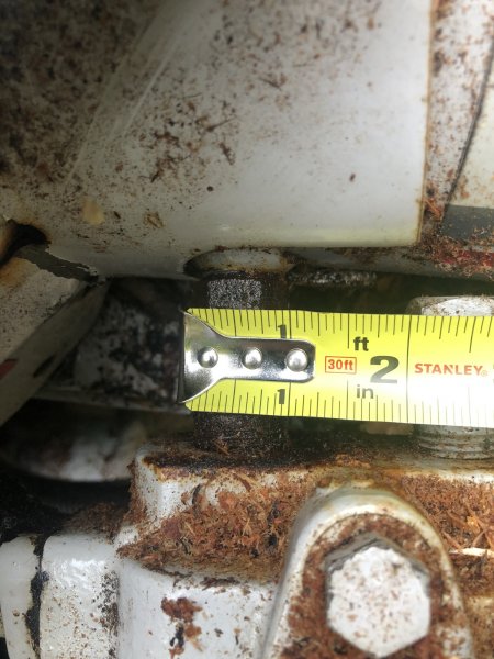

    Leaking here

  6. Screwloose
    Screwloose
    Jan 15, 2017
    5,082
    29,461
    Looks like Dave for the win!

  9. brenndatomu
    22,383
    142,148
    It's probably not rusted on so much as just really tight! Mine was anyways.
    It just threads off, but, since the fitting is cracked, it's likely that side will break off in its respective component...at that point you need a large easy out to get the broken threads out...might be easiest to take it to a hydraulic or machine shop, just have them remove it then.

    You must be referring to ID?

    Yes, NPT (what those fittings are) goes by ID

    Ok thanks. You think they’re 1/2” not 3/4”?

    Yes, you have to get into a pretty big, and often expensive splitter to have larger than 1/2" on that fitting.
    I'm not sure I've ever seen one of those Energy valves with 3/4"...and most cylinders have 1/2" ports too, unless XL, like 4.5"-5" diameter cylinder...even many of those are still 1/2"
