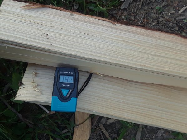

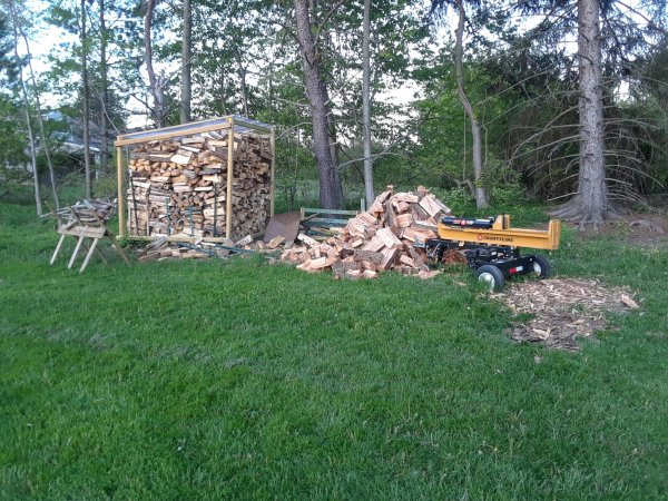

    So I did an experiment with these clear greenhouse panels and a "wood shed". Really, this is just a frame with some clear panels on top. There is truss wire keeping the whole thing together. The idea is to make a solar kiln of sorts. I need to build it out more but this is fine for now.
    I am not a patient person and would like to use my wood this winter. I have a lot of wood but it is not particularly old or seasoned wood.
    Rather than making a particularly good looking wood shed, my goal was to have a very effective wood shed.
    I had some conifers that a neighbor gave me (pressured me to take) so I split them and tossed them on the pile. I stacked them on 4/27. The moisture content was probably around the 40s if I had to guess. It was still in rounds when I loaded it up.
    I checked today, less than a month later and already, the moisture content is down to 14% on the inside of a split! Granted, this is a conifer, and it was on the top of the pile nearest the sun/heat but hey, it's working!
    Inside of conifer drying less than a month. Outside was around 7%.

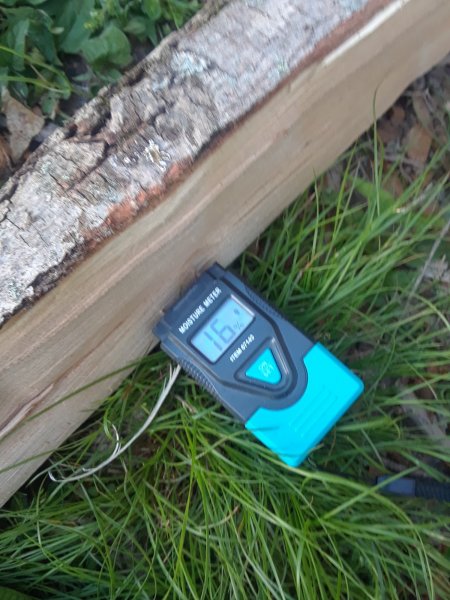

    20210518_194341.jpg outside of maple split also on the top of the pile.

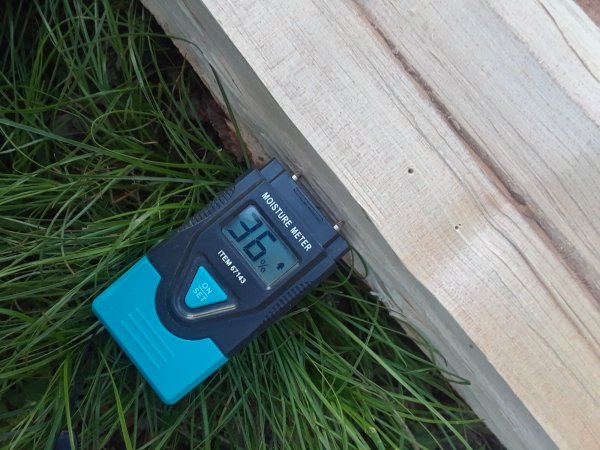

    Inside of the same maple split
    ...still more cooking for the maple but seeing as it isn't even June, I have high hopes.
