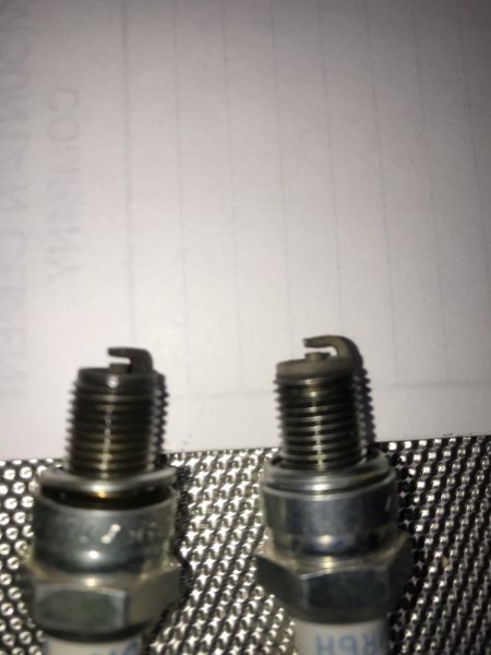

    Any pics of the old/bad plug?

    Looks a little rich. Should be a light tan. Not sure what mix your running but I have read some guys try and go less than 50:1 and have issues. I've been running 45:1 with no problems in my Stihl saws.
