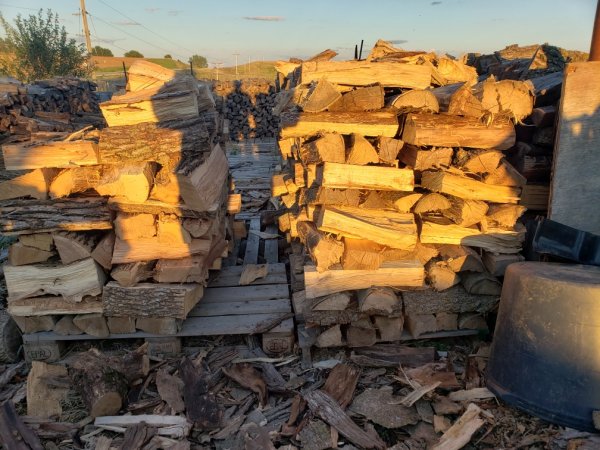

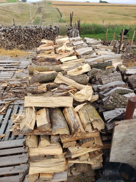

    Quick thought; how many rows do you guys stack together and how far apart do you space each row or section? I don't care for it to look nice I just want it to dry good. Sometimes I get lazy and leave no spacing like I did here, but maybe ill skip a row and do another four rows. My wood sits on top of a hill along a machine shed bit its plenty windy most days. I might have heard this from Buckin Billy Ray, but the saying goes something like "wide enough for a mouse, and narrow enough so a cat can't fit." I've got a story about a cat that actually did fit and got squashed in my stacks but thats for another day.

    I give a few inches. Ill use a 36 or 40" wide pallet and double row 16" splits. Scrap plywood over the gap and top cover. I had a bunch of wood tightly stacked and the internal splits got moldy and didnt dry well. I normally wouldnt have done that but a couple of years ago i was ppressed for space. I was able to move the stacks a year ago
    Ive triple rowed on a 48" pallet and had them too tight. Now if i do that ill leave an inch or two. Let end splits hang over a couple inches to compensate.
    From the looks of it your stacks get plenty of sun (mine dont) so that helps a lot. Space them a couple inches at least IMO for better air flow.

    I would say with that sun and wind exposure in the open field, spacing or not isn't going to be much of a game changer for you. Its the guys who store wood in the shade that's most important for.

    Yea is guess it is kind of dependent on local climate. I think my next row will have enough room to walk between stacks. I usually stack my rows facing north to south. But I feel like I could get better results west to east like that back stack in my picture. It was split earlier this summer and its already got that dark look. Stacking north to south is just easier for me though.

    Space does not appear to be an issue based on that photo for you...

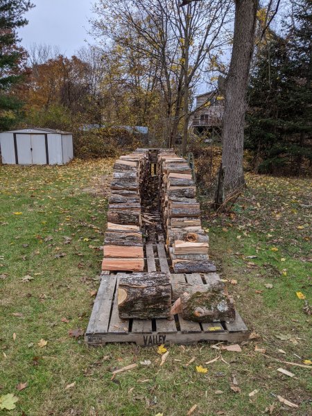

    I was stacking 3 rows wide on pallets for years, leaving just about an inch or two between the rows. Last year I figured I'd experiment a little bit with 2 rows wide, and in my neck of the woods if definitely made a difference. I'm seeing red oak and maple get down to a reasonable moisture content much faster than my previous stacking method. Of course, individual results may vary.
