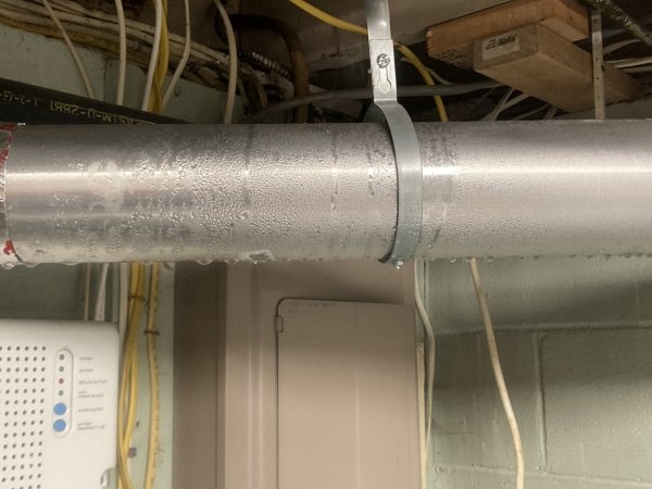

    A friend called me yesterday and stated her basement flooded ( maybe an inch of water) and that her washing machine was leaking water. What I found was that her freeze proof valve for her outside hose was leaking. I think it was shut off properly and the hose was disconnected but I believe it just leaks. I found the dryer vent above the washing machine oozing water. I cut the pipe going to the valve and capped it off. I’ll fix it when it’s warm outside. I’ve seen this before. Please keep an eye on your outside hose valves.
    AB0E398F-6984-4C25-AE75-7A625C72A020.jpeg 5E060293-6014-4491-93E5-2914614AE501.jpeg
    That’s the dryer vent under the valve. Not a good place for that.

    Those frost free hydrants are useless if you don't disconnect the hose.
    I had one many years ago the lady went out in the spring and cleaned all her porch furniture. Meanwhile the FF hydrant was split, leaking inside the kitchen sink cabinet, running down the basement steps and flooding her basement. She was out there a couple hours i guess. :hair:
    What a mess. And she had no idea till she came back in.
    They don't leak till you turn them on.

    Had one freeze last year. Haven't replaced yet I just shut the line off in side.
  7. TurboDiesel
    16,163
    96,851
    I always put a valve in for outside hydrant. Even frost free hydrants.

    When we rebuilt the entire house I switched to PEX and put a Mani-block in (it's like a circuit breaker box for the water lines), I'll shut all the outside spigots off at the panel to prevent this issue because, yes, I've had those "frost-free" valves fail more than once.

    There was a valve but no bueno!

    I have 2 outside faucets. Both, frost-free sillcocks. When installed a number of years ago, they need to be slanted down, towards outside. That's so they can drain when closed. Hoses detached. Haven't had a problem with them, so far.
