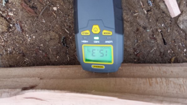

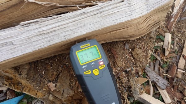

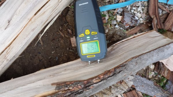

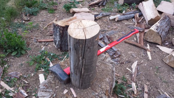

    Hopefully I can get these pictures captioned correctly but essentially, these readings prove everything I've read about seasoning times from long time burners on this site 100% correct. All of these are fresh splits.
    First is some silver maple that I css'd over labor day 2014. Was always told this was fast to dry and it sure is. This was a big split I busted and it was on the darker side of the stacks.
    This is some sugar maple that I css'd a few weeks later. The split I broke apart was smaller and it got way more sun. 20150531_200113.jpg

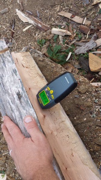

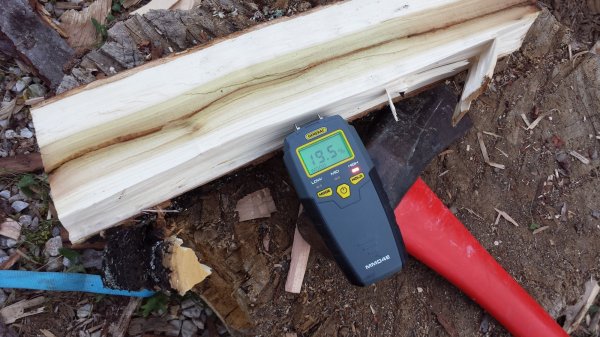

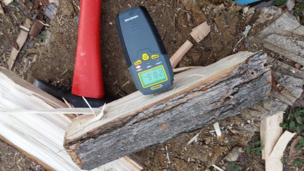

    The next one is red oak that was split small in October with optimal sun and wind. 20150531_200226.jpg This one is tulip poplar cut from a live tree in late January. I css'd it in early February. This was a bigger split on the darker side of my stacks. 20150531_200344.jpg The final one is some standing dead sugar maple my father in law dropped for me. This must have been higher up in the tree. The lower sections with bark read high 20's. 20150531_200420.jpg 20150531_200450.jpg
    Seems to me everything I've read on this site about seasoning times for various wood is dead on accurate. Only thing I would add is I thought sugar maple totally outperformed the red oak last year. I tend to think red oak is overrated.

    Well I already realize I screwed up the post..lol.. the red oak and sugar are flipped. The oak is the higher reading.
