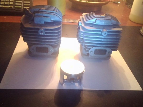

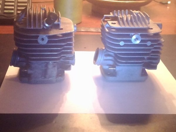

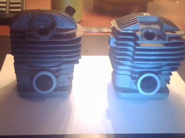

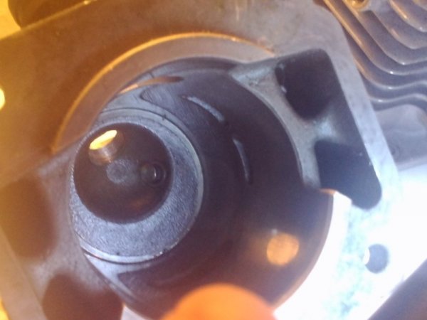

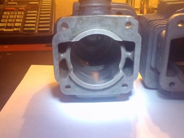

    Here are comparison pictures, Solo 665 on the left Dolmar/Mikita 6400 on the right. Both saws use exactly the same 47mm windowed single ring piston. Note that the Solo has the decomp positioned on the cylinder top and the Dolmar/Makita on the side.

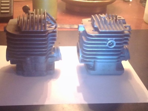

    Here are more pictures, I screwed up the first post.

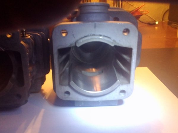

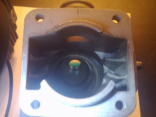

    The bases of the jugs are different Dolmar is 0.265 and Solo 0.290 a difference of about 0.635mm.

    Interesting that the design of the jugs is totally different. The Makita/Dolmar jug has six open transfer ports while the Solo is a more conventional quad-ported design. What happened? Two engineers at a standoff drew straws as to whose design went on what brand? :)

    The dolmar 6400 7300 7900 was a solo dolmar joint design. Something happen between the 2 companies and solo went on to come out with the 665 675 681. So some changes were made for the better we hope. :cool:
