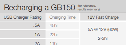

    Is there a way to figure out the ah of a lithium 4000amp battery jump starter?

    This unit: NOCO - 4000A Lithium Jump Starter - GB150 lists the recharging specs below which can be used to guess the Amp-hr. rating. Based on recharge times the pack looks to be somewhere around 22 Ah (0.5 x 45 or 1 x 22, etc.).
    That's not a lot of storage capacity for a backup system.
