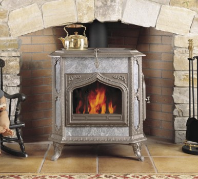

    So, a good friend and widow that is remodeling a house and wants to install a wood stove in a fireplace alcove. She has been using a Hearthstone heritage (not in the same location) approximately 5 years old so I don't know the burn system on it. And she doesn't think it has a very long burn time.
    I would like to see her use the Progress Hybrid, but she doesn't know if the side door will work. Is there another hybrid soapstone out there with a front door that is any good?
    I looked at the new Hearthstone Heritage stoves and they have a hybrid technology now but I don't know if her stove has it. What are the thoughts on the new Hearthstone hybrid technology?
    She loves soapstone and money is not a big obstacle so what's out there?
