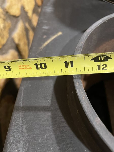

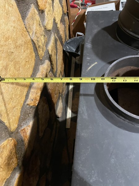

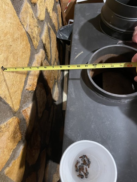

    Excuse the mess. I am waiting on a vented ash pan door being made (while using an electric heater instead of expensive fuel oil). Wanting to burn some of my 3 year seasoned wood when I get it all hooked back up. Hopefully Hitzer will call me tomorrow and I can pick it up on Saturday.
    B6E0CB67-3947-4778-8C0A-2152DE725AFD.jpeg DC7642AC-1BB1-4E7E-8413-D882EBA5BCDA.jpeg A1623A0A-F2FD-43AE-B011-564778452E4B.jpeg
    Tricky? Man...great effort for me on a hot stove. Much appreciated.
    Not sure if I explained what I needed correctly or not. That might be right. I’ll clarify what I need.
    Looking at the stove from the side I need measurement from front of stove body to the far rear side of your exhaust pipe. That may have been what you measured for me. If so, then I have enough room for a Progress on my hearth by about 3 inches. Being side load I have plenty of room on the side of my hearth and no worry of a log rolling out the front. Still think a Progress is far too big which presents the issue of burning super low all the time and not burning at all in shoulder season for that much stove still putting off way too much heat for its size for my home. I really want to avoid that. My coal stove now is too big...luckily I can idle stove body as low as 230F and sometimes even that is too much heat for the house this time of year. The full load of coal burns for 5-6 days if I let it burn from load until it goes out and this time of year with outdoor temp swings it’s often still too hot in the house. Coal is nice. Actually it is great, but windowstats means wasting fuel and wasting fuel means wasting money.
    My coal stove is top vent and 11” off the rear wall (which remains cool to touch even with stove body running 300F-350F). If I measure as if that was the rear exhaust of a Progress, then I know it will fit on the hearth because I have about 28” to the front of my hearth. That means a Palladian or FV would easily fit, rear vent or top vent...wouldn’t matter then.
    I’m using the knowledge I gained from my old wood stove and this coal stove and combining all of that with what I’m learning from you guys to help me make a better education guesstimate on the size of a new wood stove. Spending $3000-$4000 only to determine a stove is too small or too big is an expensive mistake and something I really want to avoid.
